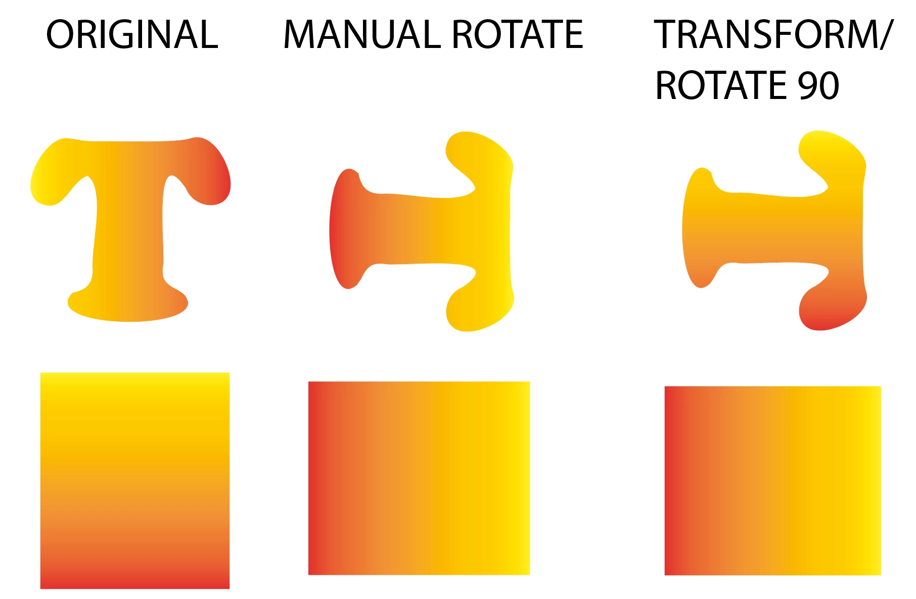

Issue Summary:
In the latest version of Adobe Illustrator, when I rotate an object manually by dragging from a corner (free transform), the gradient fill remains static and does not rotate with the object.
However, if I rotate the same object using the Object > Transform > Rotate… command, the gradient rotates as expected.
This inconsistency between two rotation methods is extremely dangerous because it’s not visually apparent until it's too late — especially in print workflows.
Due to this issue, a professional print job was sent to production and resulted in a loss of 88,000 TRY (approximately $2,700 USD), including paper, printing, die-cutting, and finishing costs.
Steps to Reproduce:
  1. Create a shape with a gradient fill.
  2. Rotate it manually using the corner handle.
  3. Notice the gradient stays fixed and does not rotate.
  4. Now rotate it using Object > Transform > Rotate… — this time the gradient rotates properly.
Expected Behavior:
Rotation behavior should be consistent regardless of the method used (manual or via panel).
Alternatively, Illustrator should provide a visible toggle or global preference setting to ensure gradients always follow object transformations.
