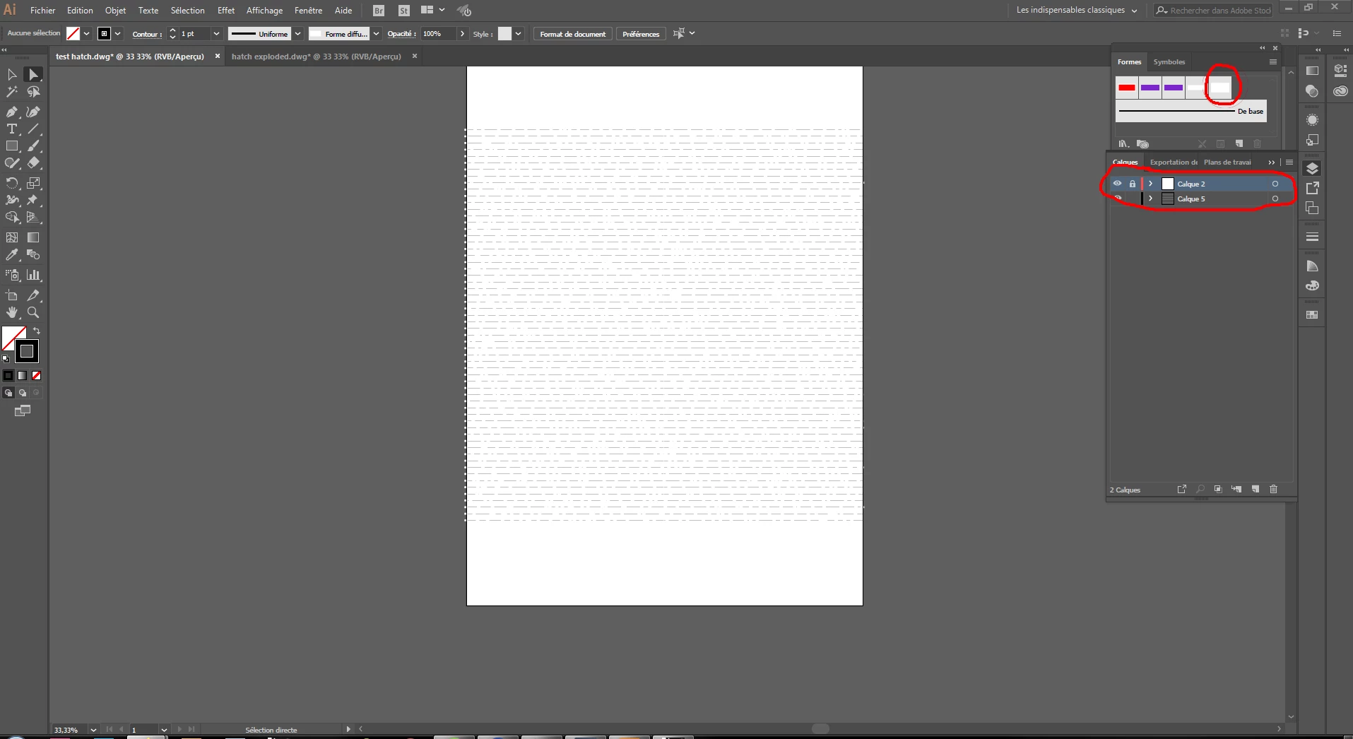

Well, obviously your scatter brush element consists of two white rectangles and therefore the straight lines on the second layer called "Line layer" are required to see the visual effect.
Is there some specific reason why you don't just use black filled or stroked paths to make the scatter brush?

Sure ! You can find it here !

If it needs to be vector artwork you could try to set up custom scatter brushes using their various random options (size, distance etc.) and apply the brushes to parallel horizontal lines.

I tried your solution with scattering a blank rectangle on the lines and it worked very well, thank you !
Just a little question, do you know if there's a way to scatter the rectangle on the lines and keeping these visible without creating a new layer  ?
I have to copy/paste my lines layer underneath the scattered one to see the result.
