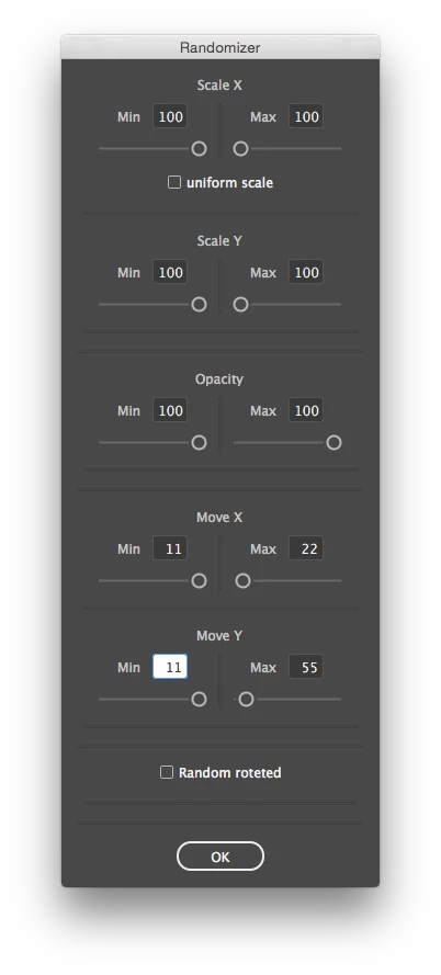

This .jsx still works, though I like Ton's suggestion better since you get a preview option.
var doc=app.activeDocument;
var s=doc.selection;
///////////////////////////////////////////////////////////////////////////////////////////////////WIDOW/////////////////////////////////////////////////////////////////////////////
var myWindow=new Window("dialog","Randomizer");
myWindow.orientation = "column";
//Scale X
    var scaleXGroup= myWindow.add("group");
    scaleXGroup.orientation = "column";
    var scaleXText=scaleXGroup.add("statictext", undefined, "Scale X");
        var scaleXGroup1=scaleXGroup.add("group");
        scaleXGroup1.orientation = "row";
        var scaleXGroupMin=scaleXGroup1.add("group");
        scaleXGroupMin.orientation = "column";
            var scaleXGroupMin1=scaleXGroupMin.add("group");
            scaleXGroupMin1.orientation = "row";
                var scaleXTextMin=scaleXGroupMin1.add("statictext", undefined, "Min");
                var scaleXMinValue = scaleXGroupMin1.add ('edittext {text: 100, characters: 3, justify: "right", active: true}');
            var scaleXMinSlider = scaleXGroupMin.add ('slider {minValue: 0, maxValue: 100, value: 100}');
        scaleXMinSlider.onChanging = function () {scaleXMinValue.text = scaleXMinSlider.value ;
                                                                        if(check1.value){
                                                                            scaleYMinValue.text = scaleXMinSlider.value;
                                                                            }else{  scaleYMinValue.text = scaleYMinSlider.value;}
        scaleXMinValue.onChanging = function () {scaleXMinSlider.value = Number (scaleXMinValue.text) ;
                                                                     if(check1.value){
                                                                        scaleYMinSlider.value = Number (scaleXMinValue.text) ;
                                                                        }else{ scaleYMinSlider.value = Number (scaleYMinValue.text) ;}
        scaleXGroup1.add ("panel", [100,0,103,50]);
        var scaleXGroupMax=scaleXGroup1.add("group");
        scaleXGroupMax.orientation = "column";
            var scaleXGroupMax1=scaleXGroupMax.add("group");
            scaleXGroupMax1.orientation = "row";
                var scaleXTextMax=scaleXGroupMax1.add("statictext", undefined, "Max");
                var scaleXMaxValue = scaleXGroupMax1.add ('edittext {text: 100, characters: 3, justify: "right", active: true}');
            var scaleXMaxSlider = scaleXGroupMax.add ("slider", undefined, 100, 100, 1000);
        scaleXMaxSlider.onChanging = function () {scaleXMaxValue.text = scaleXMaxSlider.value;
                                                                             if(check1.value){
                                                                                scaleYMaxValue.text = scaleXMaxSlider.value;
                                                                                }else{  scaleYMaxValue.text = scaleYMaxSlider.value;}
        scaleXMaxValue.onChanging = function () {scaleXMaxSlider.value = Number (scaleXMaxValue.text);
                                                                              if(check1.value){
                                                                                scaleYMaxSlider.value = Number (scaleXMaxValue.text) ;
                                                                                }else{ scaleYMaxSlider.value = Number (scaleYMaxValue.text) ;}
        var check1 = myWindow.add ("checkbox", undefined, "uniform scale");
        myWindow.add ("panel", [0,20,250,23]);
//Scale Y
    var scaleYGroup= myWindow.add("group");
    scaleYGroup.orientation = "column";
    var scaleYText=scaleYGroup.add("statictext", undefined, "Scale Y");
        var scaleYGroup1=scaleYGroup.add("group");
        scaleYGroup1.orientation = "row";
        var scaleYGroupMin=scaleYGroup1.add("group");
        scaleYGroupMin.orientation = "column";
            var scaleYGroupMin1=scaleYGroupMin.add("group");
            scaleYGroupMin1.orientation = "row";
                var scaleYTextMin=scaleYGroupMin1.add("statictext", undefined, "Min");
                var scaleYMinValue = scaleYGroupMin1.add ('edittext {text: 100, characters: 3, justify: "right", active: true}');
            var scaleYMinSlider = scaleYGroupMin.add ('slider {minValue: 0, maxValue: 100, value: 100}');
        scaleYMinSlider.onChanging = function () {   if(check1.value){
        scaleYMinValue.onChanging = function () {  if(check1.value){
                }else{ scaleYMinSlider.value = Number (scaleYMinValue.text) ;} }
        scaleYGroup1.add ("panel", [100,0,103,50]);
        var scaleYGroupMax=scaleYGroup1.add("group");
        scaleYGroupMax.orientation = "column";
            var scaleYGroupMax1=scaleYGroupMax.add("group");
            scaleYGroupMax1.orientation = "row";
                var scaleYTextMax=scaleYGroupMax1.add("statictext", undefined, "Max");
                var scaleYMaxValue = scaleYGroupMax1.add ('edittext {text: 100, characters: 3, justify: "right", active: true}');
            var scaleYMaxSlider = scaleYGroupMax.add ("slider", undefined, 100, 100, 1000);
        scaleYMaxSlider.onChanging = function () {
            if(check1.value){
        scaleYMaxValue.onChanging = function () {
            if(check1.value){
        myWindow.add ("panel", [-10,20,250,23]);
//Opacity
    var opacityGroup= myWindow.add("group");
    opacityGroup.orientation = "column";
    var opacityText=opacityGroup.add("statictext", undefined, "Opacity");
        var opacityGroup1=opacityGroup.add("group");
        opacityGroup1.orientation = "row";
        var opacityGroupMin=opacityGroup1.add("group");
        opacityGroupMin.orientation = "column";
            var opacityGroupMin1=opacityGroupMin.add("group");
            opacityGroupMin1.orientation = "row";
                var opacityTextMin=opacityGroupMin1.add("statictext", undefined, "Min");
                var opacityMinValue = opacityGroupMin1.add ('edittext {text: 100, characters: 3, justify: "right", active: true}');
            var opacityMinSlider = opacityGroupMin.add ('slider {minValue: 0, maxValue: 100, value: 100}');
        opacityMinSlider.onChanging = function () {opacityMinValue.text = opacityMinSlider.value }
        opacityMinValue.onChanging = function () {opacityMinSlider.value = Number (opacityMinValue.text) }
        opacityGroup1.add ("panel", [100,0,103,50]);
        var opacityGroupMax=opacityGroup1.add("group");
        opacityGroupMax.orientation = "column";
            var opacityGroupMax1=opacityGroupMax.add("group");
            opacityGroupMax1.orientation = "row";
                var opacityTextMax=opacityGroupMax1.add("statictext", undefined, "Max");
                var opacityMaxValue = opacityGroupMax1.add ('edittext {text: 100, characters: 3, justify: "right", active: true}');
            var opacityMaxSlider = opacityGroupMax.add ("slider", undefined, 100, 0, 100);
        opacityMaxSlider.onChanging = function () {opacityMaxValue.text = opacityMaxSlider.value }
        opacityMaxValue.onChanging = function () {opacityMaxSlider.value = Number (opacityMaxValue.text) }
//Move X
    var moveXGroup= myWindow.add("group");
    moveXGroup.orientation = "column";
    var moveXText=moveXGroup.add("statictext", undefined, "Move X");
        var moveXGroup1=moveXGroup.add("group");
        moveXGroup1.orientation = "row";
        var moveXGroupMin=moveXGroup1.add("group");
        moveXGroupMin.orientation = "column";
            var moveXGroupMin1=moveXGroupMin.add("group");
           moveXGroupMin1.orientation = "row";
                var moveXTextMin=moveXGroupMin1.add("statictext", undefined, "Min");
                var moveXMinValue = moveXGroupMin1.add ('edittext {text: 0, characters: 3, justify: "right", active: true}');
            var moveXMinSlider = moveXGroupMin.add ("slider", undefined, 0, -1000, 0);
        moveXMinSlider.onChanging = function () {moveXMinValue.text = moveXMinSlider.value }
        moveXMinValue.onChanging = function () {moveXMinSlider.value = Number (moveXMinValue.text) }
        moveXGroup1.add ("panel", [100,0,103,50]);
        var moveXGroupMax=moveXGroup1.add("group");
        moveXGroupMax.orientation = "column";
            var moveXGroupMax1=moveXGroupMax.add("group");
            moveXGroupMax1.orientation = "row";
                var moveXTextMax=moveXGroupMax1.add("statictext", undefined, "Max");
                var moveXMaxValue = moveXGroupMax1.add ('edittext {text: 0, characters: 3, justify: "right", active: true}');
            var moveXMaxSlider = moveXGroupMax.add ("slider", undefined, 0, 0, 1000);
        moveXMaxSlider.onChanging = function () {moveXMaxValue.text = moveXMaxSlider.value }
        moveXMaxValue.onChanging = function () {moveXMaxSlider.value = Number (moveXMaxValue.text) }
//Move Y
    var moveYGroup= myWindow.add("group");
    moveYGroup.orientation = "column";
    var moveYText=moveYGroup.add("statictext", undefined, "Move Y");
        var moveYGroup1=moveYGroup.add("group");
        moveYGroup1.orientation = "row";
        var moveYGroupMin=moveYGroup1.add("group");
        moveYGroupMin.orientation = "column";
            var moveYGroupMin1=moveYGroupMin.add("group");
            moveYGroupMin1.orientation = "row";
                var moveYTextMin=moveYGroupMin1.add("statictext", undefined, "Min");
                var moveYMinValue = moveYGroupMin1.add ('edittext {text: 0, characters: 3, justify: "right", active: true}');
            var moveYMinSlider = moveYGroupMin.add ("slider", undefined, 0, -1000, 0);
        moveYMinSlider.onChanging = function () {moveYMinValue.text = moveYMinSlider.value }
        moveYMinValue.onChanging = function () {moveYMinSlider.value = Number (moveYMinValue.text) }
        moveYGroup1.add ("panel", [100,0,103,50]);
        var moveYGroupMax=moveYGroup1.add("group");
        moveYGroupMax.orientation = "column";
            var moveYGroupMax1=moveYGroupMax.add("group");
            moveYGroupMax1.orientation = "row";
                var moveYTextMax=moveYGroupMax1.add("statictext", undefined, "Max");
                var moveYMaxValue = moveYGroupMax1.add ('edittext {text: 0, characters: 3, justify: "right", active: true}');
            var moveYMaxSlider = moveYGroupMax.add ("slider", undefined, 0, 0, 1000);
        moveYMaxSlider.onChanging = function () {moveYMaxValue.text = moveYMaxSlider.value }
        moveYMaxValue.onChanging = function () {moveYMaxSlider.value = Number (moveYMaxValue.text) }
        var check2 = myWindow.add ("checkbox", undefined, "Random roteted");
        var ok_button = myWindow.add ("button", undefined, "OK");
      ok_button.onClick = randimizeFunc;
if(s.length<1){
    alert("No selected objects");
    } else{
       myWindow.show ();
   function randimizeFunc(){
       myWindow.hide();
        var xScaleMin=scaleXMinSlider.value;
        var xScaleMax=scaleXMaxSlider.value;
        var yScaleMin=scaleYMinSlider.value;
        var yScaleMax=scaleYMaxSlider.value;
        var xMoveMin=moveXMinSlider.value;
        var xMoveMax=moveXMaxSlider.value;
        var yMoveMin=moveYMinSlider.value;
        var yMoveMax=moveYMaxSlider.value;
        var opacityMin=opacityMinSlider.value;
        var opacityMax=opacityMaxSlider.value;
        var rot=check2.value;
        var unifScale;
        for(var i=0;i<s.length;i++){
            if(check1.value){
                unifScale=xScaleMin+Math.random()*(xScaleMax-xScaleMin);
                s.resize(unifScale,unifScale);
                }else{
                             if(xScaleMin!=xScaleMax){
                            s.resize(xScaleMin+Math.random()*(xScaleMax-xScaleMin),100);
                            if(yScaleMin!=yScaleMax){
                            s.resize(100,yScaleMin+Math.random()*(yScaleMax-yScaleMin));
                if(opacityMin!=opacityMax){
                    s.opacity=(opacityMin+Math.random()*(opacityMax-opacityMin));
                    } else{
                         s.opacity=(opacityMin);
                 if(xMoveMin!=0 || xMoveMax!=0){
                    s.translate(Math.random()*(xMoveMax-xMoveMin)+xMoveMin);
                    if(yMoveMin!=0 || yMoveMax!=0){
                    s.translate(0,Math.random()*(yMoveMax-yMoveMin)+yMoveMin);
                 if (rot){
                     s.rotate (Math.random()*360);

Or try Object > Transform > Transform Each... with Move and the Random checkbox checked.
tomkoomAuthor
December 9, 2016
thanks, this is close to what i meen but objects fall outside the artboard
Ton Frederiks
December 10, 2016
Maybe someone in the Scripting forum can help with that.
Illustrator Scripting
Barb Binder
December 9, 2016
How about using the symbol sprayer tool?
