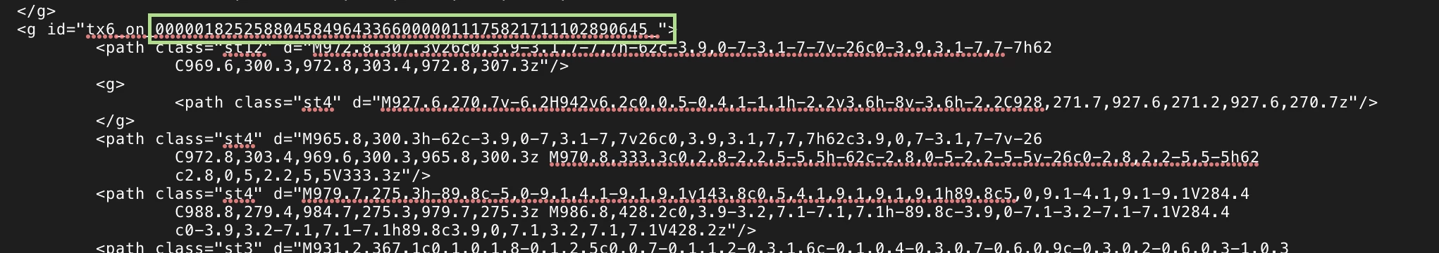

I've got a problem that is getting me crazy. Yesterday I modified an illustrator file that I used to export in SVG so the web programmer can put on a website page.
I named the main objects levels to find them easily on the code and everything went right until yesterday. Now when I try to export it some IDs (not all) generates random numbers at the end og the name and I can't understand why.
Can someone help me?
Thanks

Jun 6, 2024 6:47 AM UTC
I had the same issue today on a document I've been using for 6 years.
After joining two paths together using the pen tool clicking on the nodes. This merged an existing path with a name "PER" with an unnamed path. When I 'Save As' SVG the id added the random number on the end id="PER_0000XXXXXXXXXXXXXXXXXXXXXXXXXXXXXXXX_".
So I renamed it to "PER_", then 'Save As' SVG again, and it was now id="PER_x5F_".
Then I renamed back to "PER", then Saved the AI file.
Next 'Save As' SVG again, and it was now back to the correct id="PER".
Hope that works for others.
