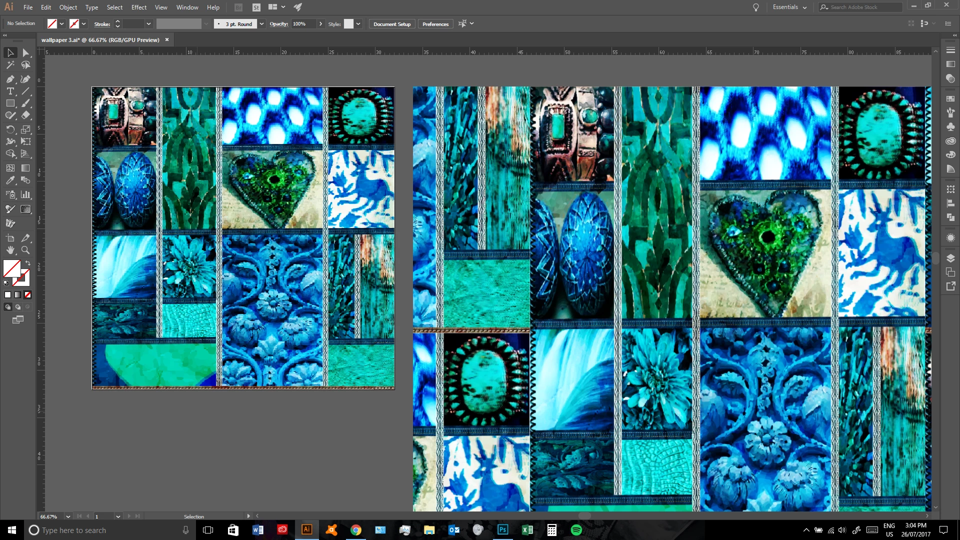

After using image trace, then rasterize and flatten to minimise file size, the edges of my images that have been traced have wonky edges therefore I canno't tile out all my images (traces) in one artboard to line up evenly, I have to have borders around the traces to hide the wonky edges. Any ideas on how I can use the effects listed above but end up with straight edges on my traces, so I dont have to add borders to each pic (trace)?

You could draw a rectangle that's just inside the rough edges, and use that as a clipping mask (make sure the rectangle is in front, select both the rectangle and the trace, then Object > Clipping Mask > Make.
If you need to rasterise, then I'd leave it until you've finished the whole composition, duplicate it all onto a new layer, and rasterise that. That way, you keep the vectors should you need to go back and change anything, or re-rasterise for different purposes.

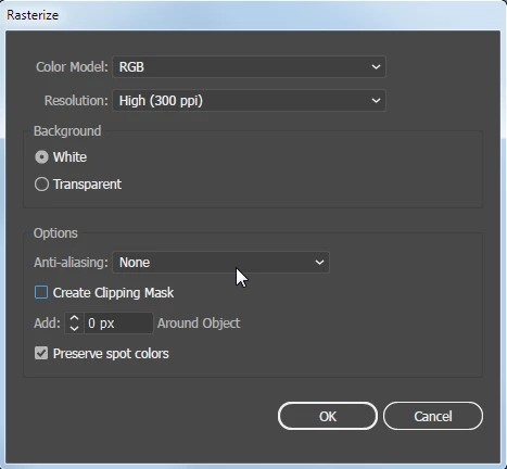

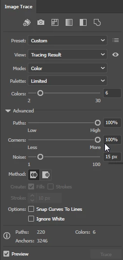

The wonky edges on the vector results of the Image Trace may not be avoidable because Image Trace is not 100% accurate, and it also depends on the quality of the original image. However, you could try setting Corners to 100%. Setting Paths to 100% might also be helpful.
If you must rasterize the vector, you could try setting Anti-aliasing to None.
