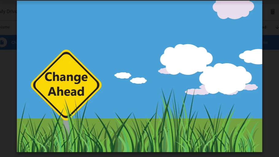

    I know this is really late, but hopefully it will help others who have the same question. A great (and free) solution is Google Drive. I save all my ai files there, and they are viewable without any conversion; at least at the time of this post (06 October 2016). I just log into drive, click on the file and it is available.
    Below is a screenshot of one of my ai files.

    this doesn't work for files saved without PDF compatibility either -- that was the actual topic question.
