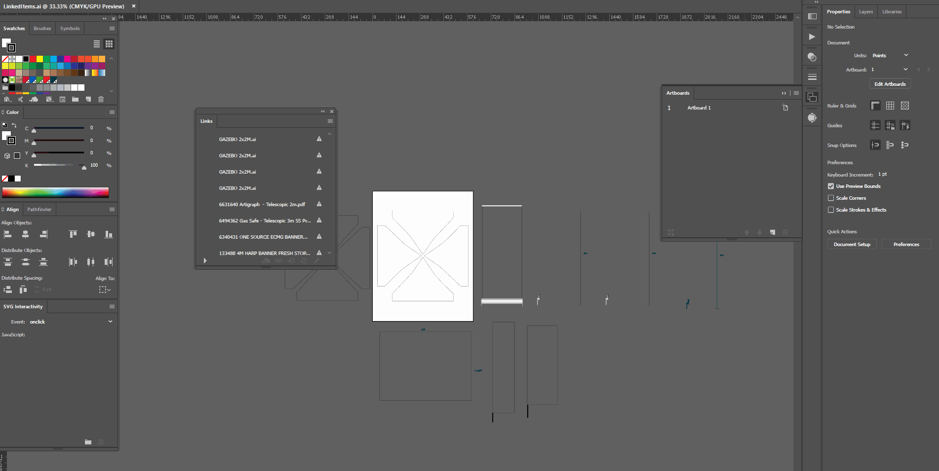

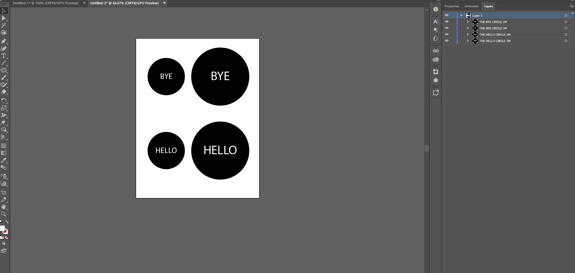

So I would as the title suggest read information from another open document/tab
So if i have art boards with constant similar names it does a close match to an object and if found select copy it and paste on the art board with that name.
I hope this GIF makes sense of what I would like to accomplish. If you cannot see what is happening just right click and open image in new tab
Thank you!

May 21, 2018
Alright so I have this working for the most part thanks to the ScriptUI PDF documentation.
however it only works in the dialogue window, the minute i make it the palette window so that I can always keep it active and add if needed it throws an error at the bottom
// This works well to search but have to be on window and would need to keep launching the script
var w = new Window ('dialog {text: "Linked objects script", alignChildren: "fill"}');
// This would be better since i can work and have it active at all times but it throws and error on the code below it
var w = new Window ('palette {text: "Quick select", alignChildren: "fill"}');
null is not an object on the loop section here (var i = 0; i < list.selection.length; i++)

Video of the dialogue part working as you can see I cannot click or do anything on the artboard until i close the script.
