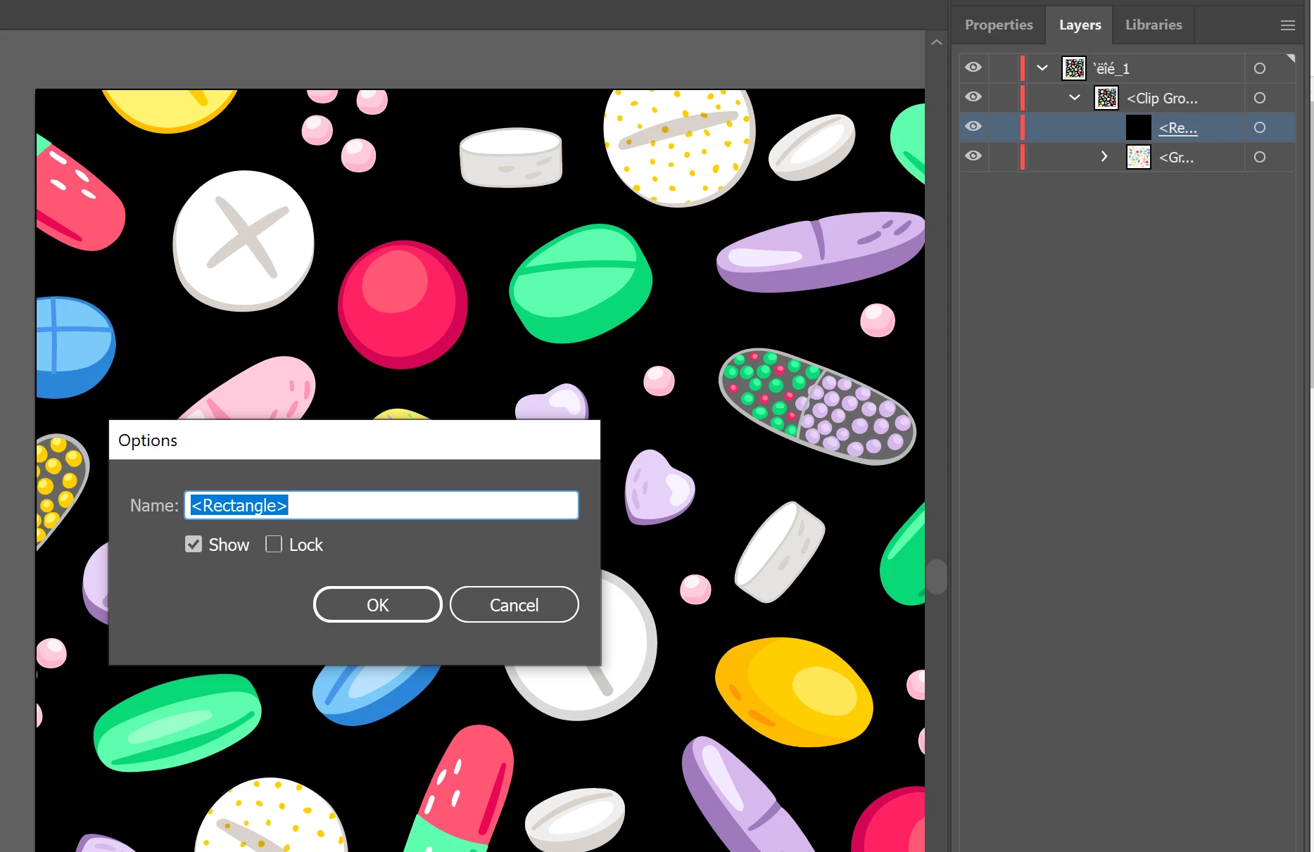

    Thanks for your reply. So I can see that it is a layer, but when I double click on it as I have done below, there is no option to change the colour, just to rename it? It appears to be unlocked also.

    This image completely helps!
    It looks like your Rectangle is actually part of a clipping group (here's Adobe's Helpx: https://helpx.adobe.com/illustrator/user-guide.html/illustrator/using/clipping-masks.ug.html)
    The giant rectangle may be just cutting off some of those pills.
    Open up the group (collapsed image of pills) and check out what's inside there?
