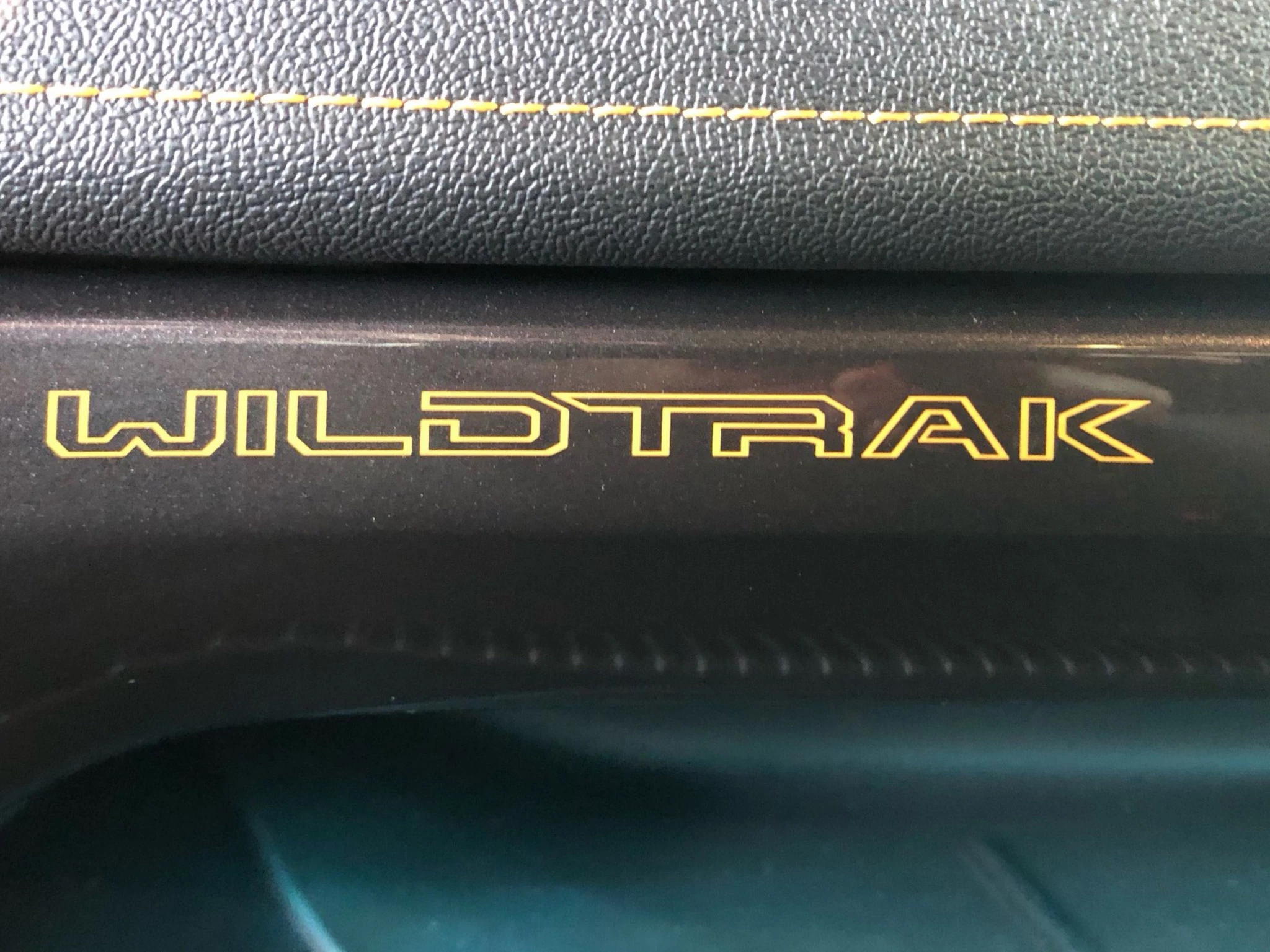

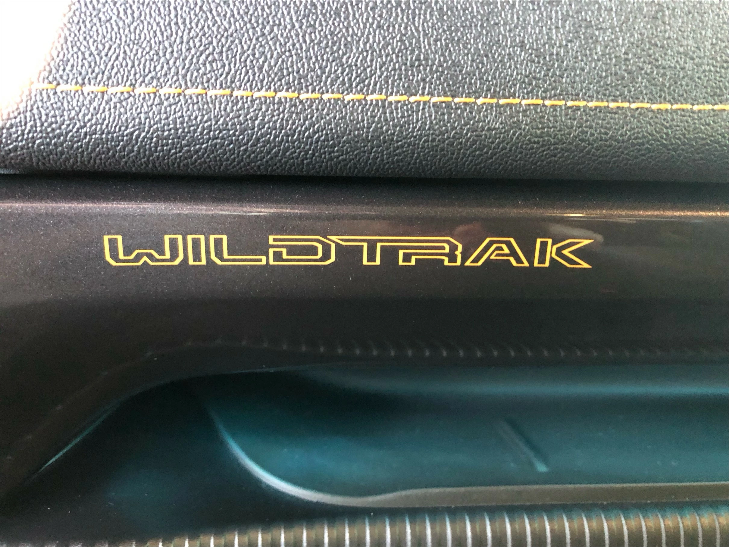

I am needing to recreate a decal for someone and only have the attached photos to go off.
The font doesn't seem to exist and I can't find this exact logo online anywhere.
How can I make a vector of the text in this photo so that I can create new decals?
I attempted to image trace, and while it kind of worked, the text was skewed due to the angle of the photo, and the edges came out super wavy.
Any help would be great! Thanks 🙂

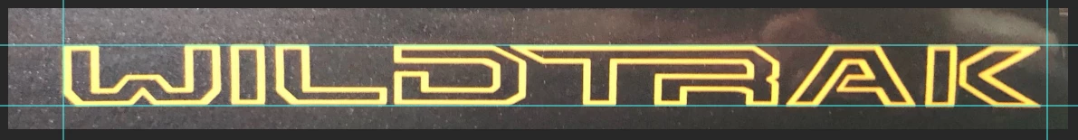

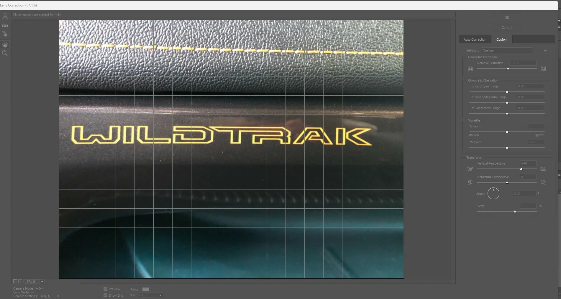

I use "Lens Correctio" in Photoshop for removing distortion,  You can try it in Ps. The result is attached. Also try Match Fonts in Ps for finding similar fonts. https://youtu.be/fbBYfYyfv5c

Because wildtrak.jpg is the least distorted, I'd recommend opening it up in Photoshop to fix its distortion and then either use Image Trace on it or manually trace it.
Here's how:
  1. Crop it so that it's mostly the text with a little margin around it
  2. Enable the Ruler (View > Ruler) so that you can drag out guides
  3. Drag a guide from the top to align to the top of the text and another to align to the bottom
  4. Drag a guide from the left to align to the left of the text and another to align to the right
  5. Go to Edit > Transform > Warp and move the anchor points and handles to align the text visually to the guides
Then use the result in Illustrator to use Image Trace on it (it may need some cleanup though) or use the Pen tool to manually trace it.
