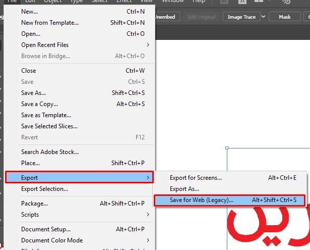

    Muqqarib Hassan
    October 15, 2018
    Hi, I apology my mistake.
    Go to Export and select Export for web.
    then you got this window.
    There you can see the option to adjust the size of your png file.
    Thanks.

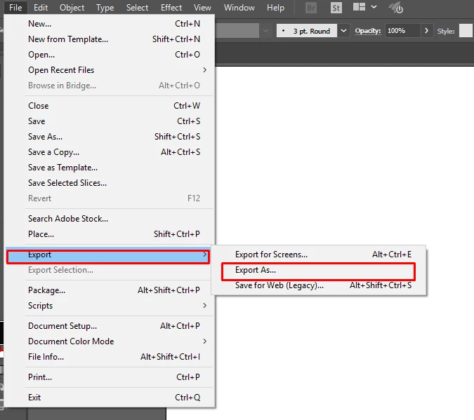

    Muqqarib Hassan
    October 15, 2018
    Hi, Try to use this method for png file reducing.
    Thanks.

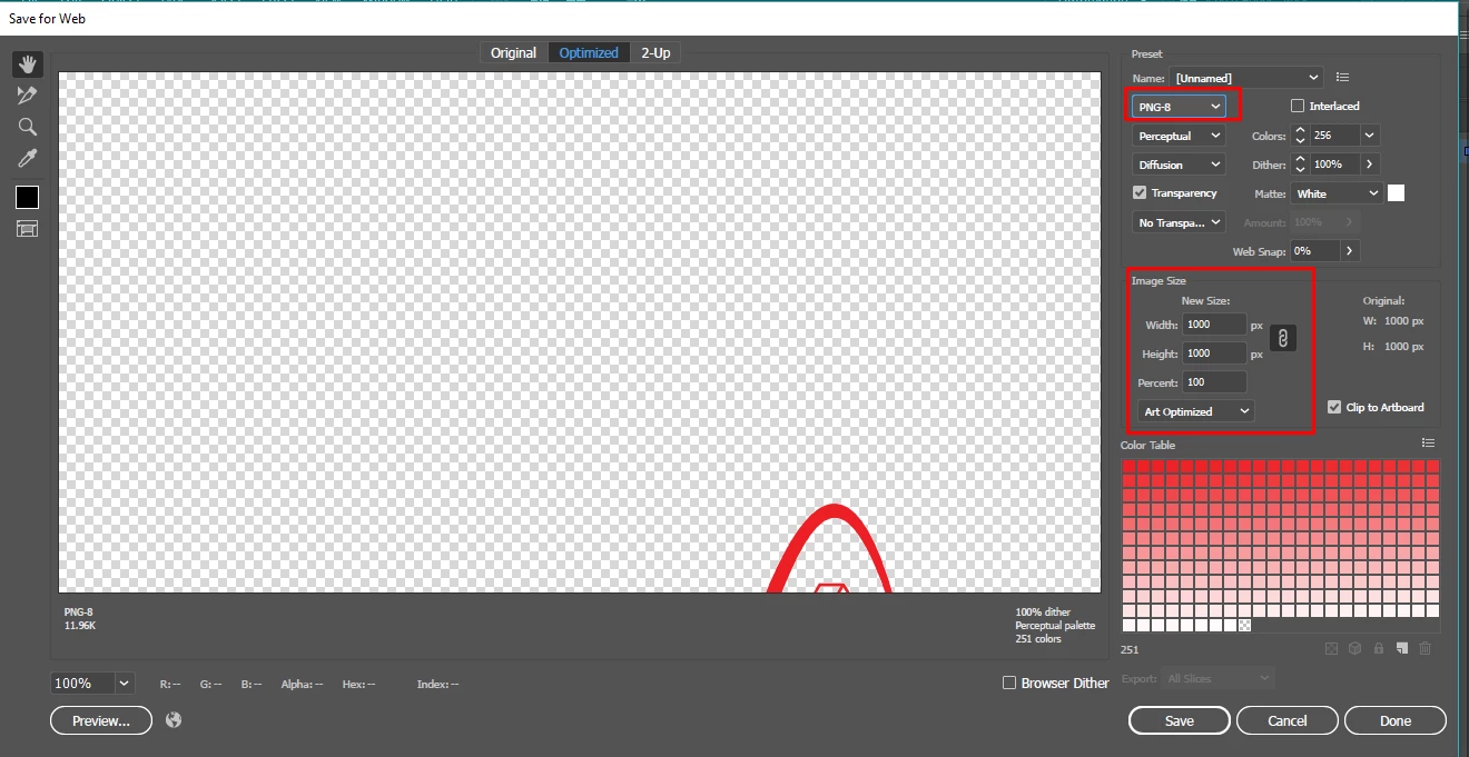

    Monika Gause
    October 15, 2018
    Try Export for screens instead.
    If that is still not enough, try the online service yourself. Or maybe the web developers convert your PNG 24 to a PNG 8. With Export for screens you can create a different PNG 8
