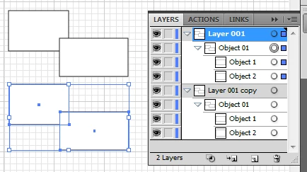

initially I have this
- layer 001
   - object 01
      - object 1
      - object 2
release to layers(sequence) on object 01 gives
- layer 001
  - layer 91(whatever the layer number illustrator gives when release to layers are performed)
    - layer 92
       - object 1
    - layer 93
        - object 2
now I need to convert them to (so that layer can retain the name of the object)
- layer 001
  - layer 01
    - layer 1
       - object 1
    - layer 2
       - object 2
I have hundreds of layer 001, and couple thousands of object 01, and wonder if anything can be done with script to do this...
Maybe faster to recreate the artwork than manually do this..
Any help would be greatly appreciated.

Found out they are actually compoundPathItems.
As I asked in the next post, I'm wondering If I can get Layers + compoundPathItems in their original order.
object.layers
object.compoundPathItems
will give me all of them, but not in the original order.
