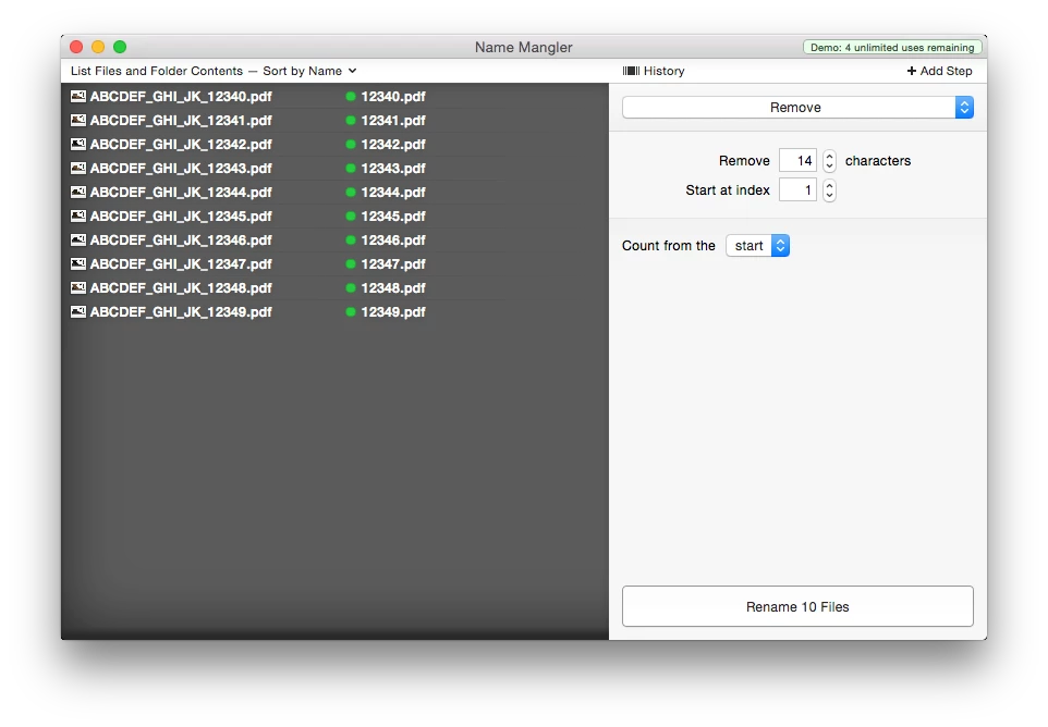

I have found that the program Name Mangler​ does an exceptional job of accomplishing the renaming task. Here is a screenshot of what I'm asking for looks like with that program.
My ultimate goal is to be able to build that single functionality of Name Mangler into the existing script I posted above. Now, the catch is that I ONLY need it to affect the file created by the section of Lines 66-71. As you can see, I need it to remove 14 characters from the filename starting at the index.
