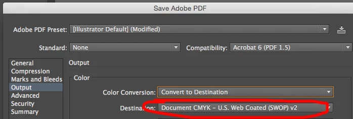

What is your destination profile.
February 18, 2017
Destination profile or Intent is the same Fogra profile
