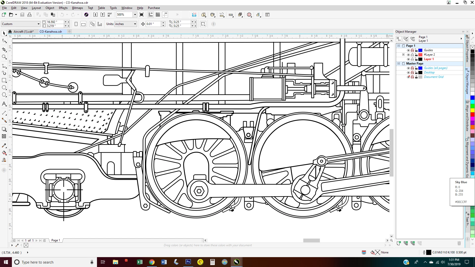

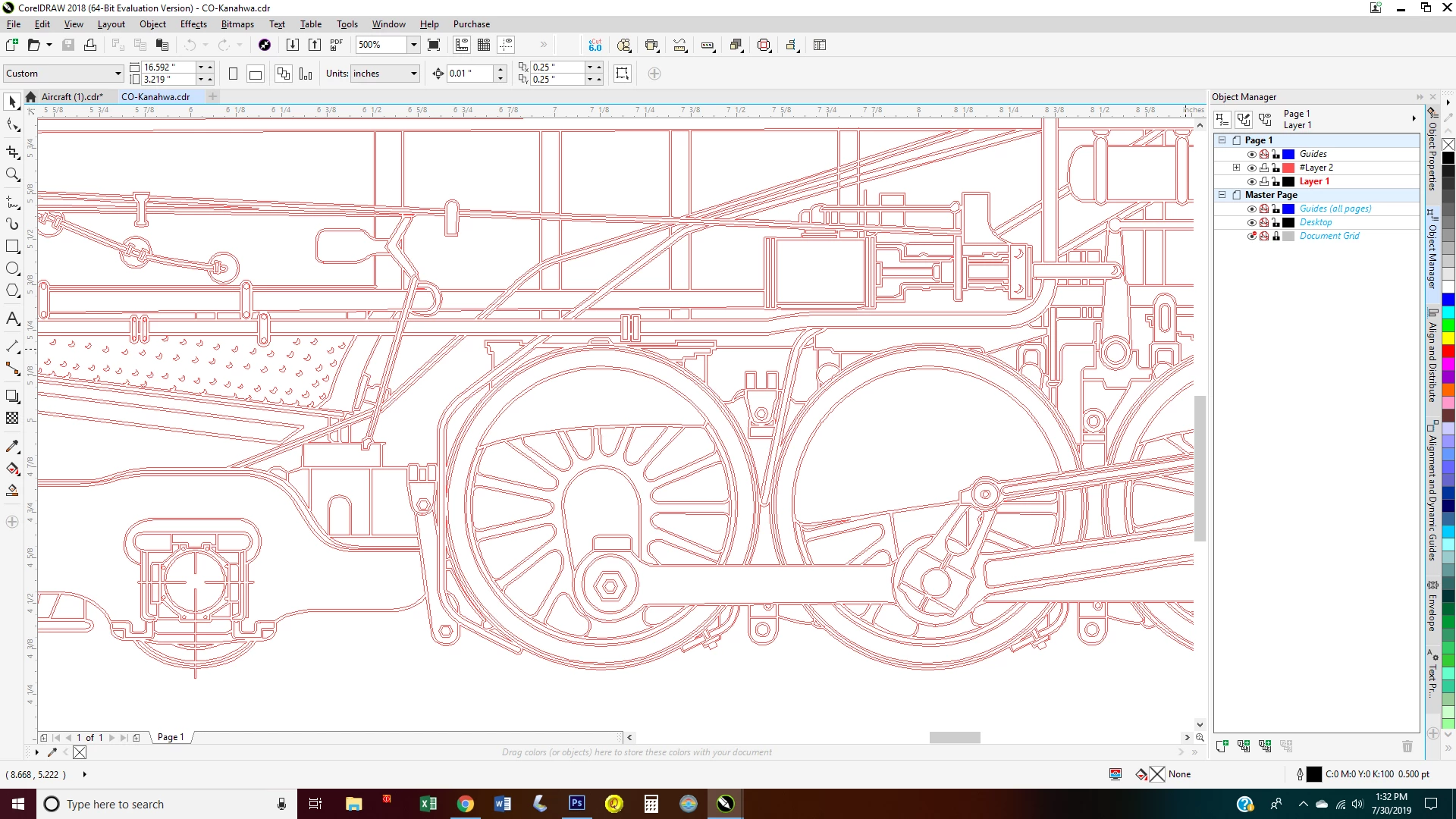

FIrst off, I am not an illustrator user. I use CorelDraw as it was the preferred software for my laser manufacture.
Recently I had a drawing vectorized that was created in Illustrator. When I open the drawing in Corel, the lines show up as fills and not lined. When I vector engrave this, it reads the outline of the lines and passes twice. It also doesn't allow for me to edit the drawing as the lines all connected. If I break apart the lines, I am breaking the outline and not the line. I have run into this before and the creator was able to change a setting on their end and save it in such a way that I could open it as a single line.
These images show the natural view (black) and the wireframe view (red).
Thanks

    jane-e
    July 30, 2019
    Hi Dave,
    It appears that they used Image Trace and gave you fills, not strokes. If you post the .ai file through dropbox or another file sharing service, we can take a quick look.
