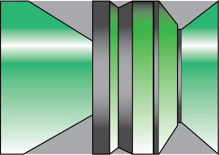

Hi Illustrators,
  I managed to create the Illustrator image I want & now need to take this image & use it in another application.  However, regardless of which way I attempt to export - jpg, tif or png, I'm still getting the (white artboard) background, which I do not want.  I attempted to create another box & blend the background to the background of the other application that I am using, but it's still apparent.
  Also, with some conversion, my image became distorted or changed the image colors a little bit.
What's the process to remove unwanted backgrounds from Illustrator images?  Here's some samples.
Thanks

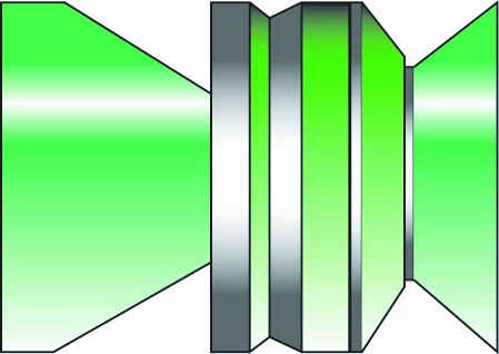

    Correct answer PrepressPro1
    Hi Jesseham,
         I do not see the options for "save for web" or to check transparency in the Save AS or Export options. Where are these options?
    Thanks
    Here is the PNG with transparency using the Save for Web & Devices…
    I had to change the internal B&W grads of the object because transparency was used to make the grads which will cause the background to show through the grads when you place these in your Web Program. You will need to redo the Gradations to replace the transparency with White.

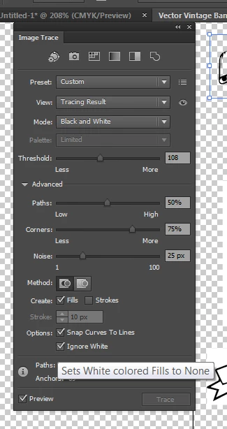

    April 23, 2015
    Illustrator Tip: How to Remove White Background in Live Trace | dezign Musings I sort of used this tutorial but I am using Illustrator CC and the steps are a little different
    but you have to fin the image trace panel,  then click Advanced and make sure the ignore white box is checked. Then Viola! transparent background.

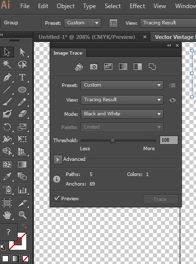

    toshk10005830
    May 18, 2018
    Hi there what are the steps to remove in CC? having trouble getting the image trace panel to work, its greyed out
    Monika Gause
    May 18, 2018
    Please show us a screenshot of your template in the layers panel.
    Most probably it's inside a clipping mask.

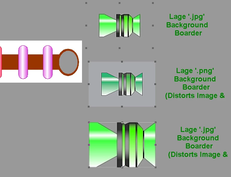

    October 29, 2009
      I attached 3 files for review.
    • The 'Gas Turbine_jpg_w_Background.ai' file has a large gray back ground which blends nicely to the JLooxMaker background, however image is not at desired size because of background boarder & image also is not as clear as desired
    • The 'Gas Turbine_jpg_w_Background_Resized.ai' file has the desired image size - 111x 75 & desired background that blends in with JLooxMaker background, but shows boarder edge, which is not wanted.  Also, image gets distorted, but it's not to bad
         Both 'jpg' images became brighter during conversion then the original image & we have a color scheme that we are trying to follow.
    • The 'png' kept the same color scheme & the image is little cleaner then the 'jpg's', but for whatever reasons, changed the shading of the background during conversion that clearly shows & does not match JLooxMaker background
         JLooxMaker is a GUI interface that needs to be used in another application that will put tags or links into it.  Kind of a confusing process, but what we are trying to capture is "clean" Illustrator images that can be converted to JLooxMaker images.
      I also attached a picture to visulize the differences.
    Hope this helps.
