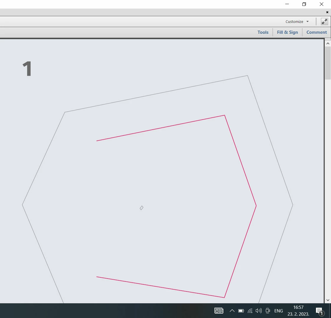

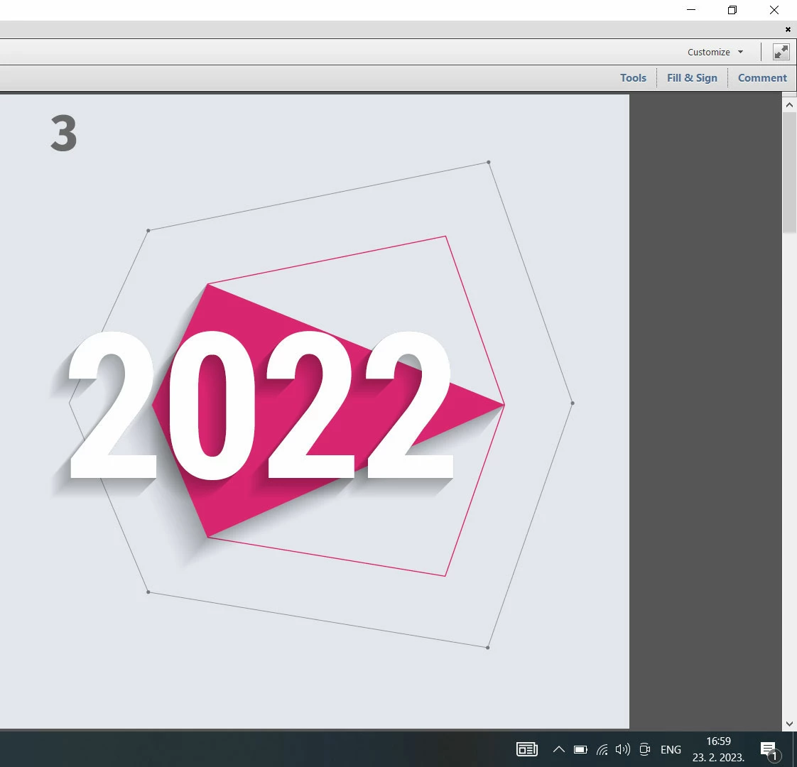

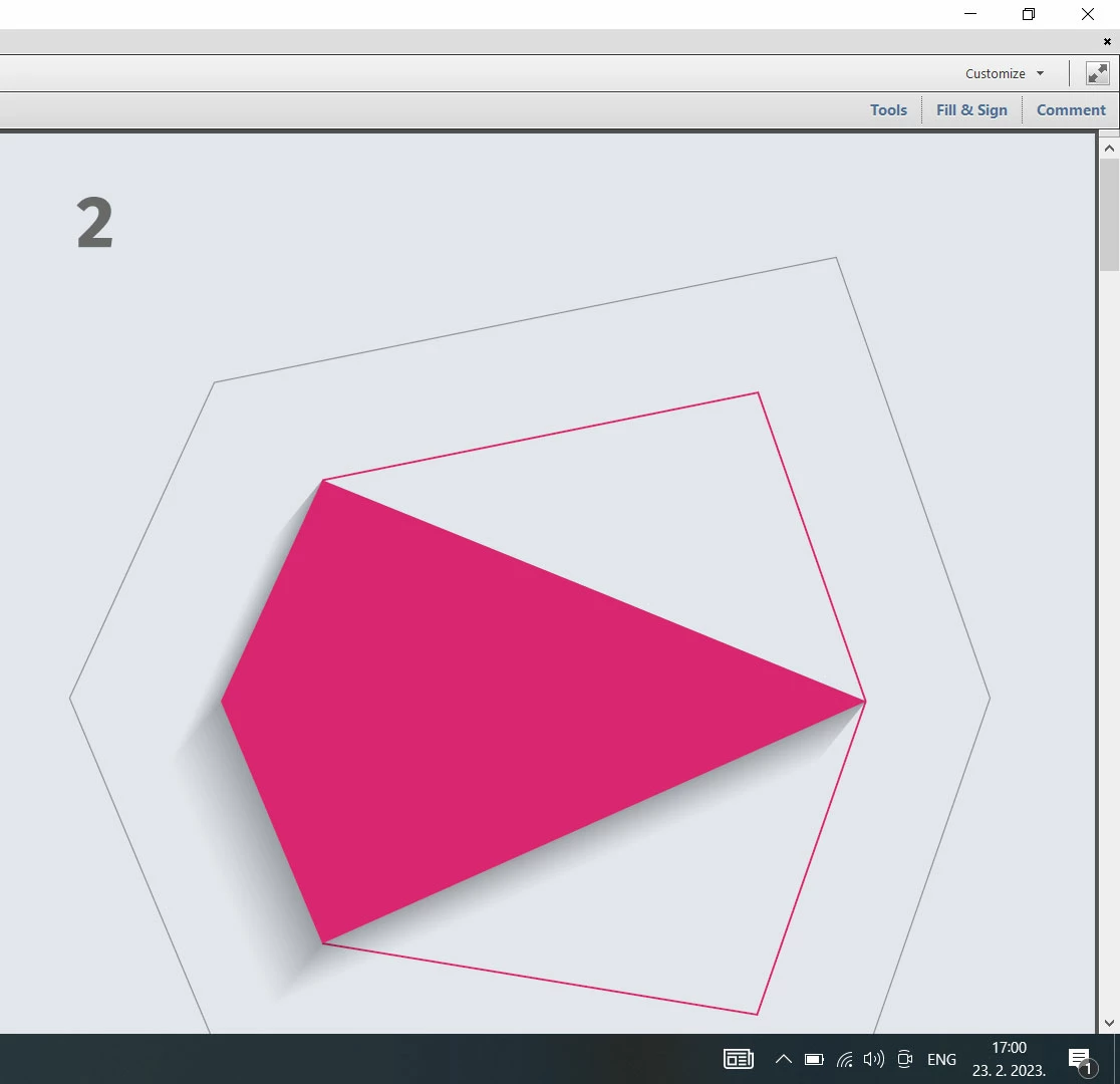

I created a brochure in Illustrator and exported it as a pdf. When I open that pdf file, it takes time to fully load, it seems to me that is opening layer by layer. It takes 2-3 sec to fully open. Also, the same problem happens when zooming. Please take a look at the attachments to better understand.
What I did in Illustrator, is that I created shadows via blend mode, and I think that's causing the problem.
So, what can I do to solve the problem? Except, to remove the shadows.
