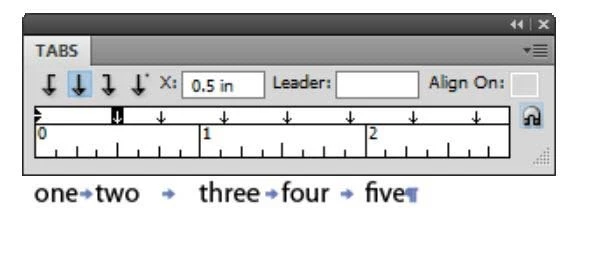

    Thank you. I can reproduce that in the latest version. It sets the first automatic tabstop *somewhere* and then the following ones in the expected distance. Looks like a bug to me. But even if it gets fixed, it will not be in version CS4.
    I could get a somewhat better result when I set 2 tabstops in the way I wanted, then selected the first one and repeated that. But then Illustrator moved my second tabstop by 0.3 mm before setting the following ones in the desired distance.

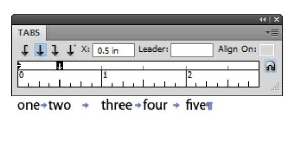

    Hello Monika,
    I’ve attached two files. The first, I have some text with a tab between each word and set the first tab at 0.5in. The second, with the first tab stop selected, I click on Repeat Tab in the menu of the TABS panel. And this is what I get! I expect tabs at every 0.5in, not this.
