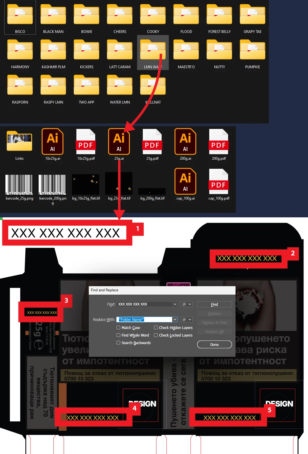

Hello. I need your help.
Definition:
There are so many folders in the "mass" work I do.
As templates, they all contain the same ai files.
I can't do them all in the same ai file. I need to make folder by folder.
Request:
I want to replace the fixed and identical texts written "Xyz Xyz Xyz Xyz" in the ai files in the folder with "the name of the current folder". I do this with Find & Replace, but I can make mistakes because I copy and paste manually. Can I automate this with jsx file or action?
Note:
The names "Xyz Xyz Xyz Xyz" are all on the same Layer and there is nothing else on the layer. It is always visible. It's not locked.
"Xyz Xyz Xyz Xyz" in different sizes and rotations.
I need to use spaces in folder names. Therefore, if it will pull data like "%20", I should replace it with " ".
Thanks in advance.

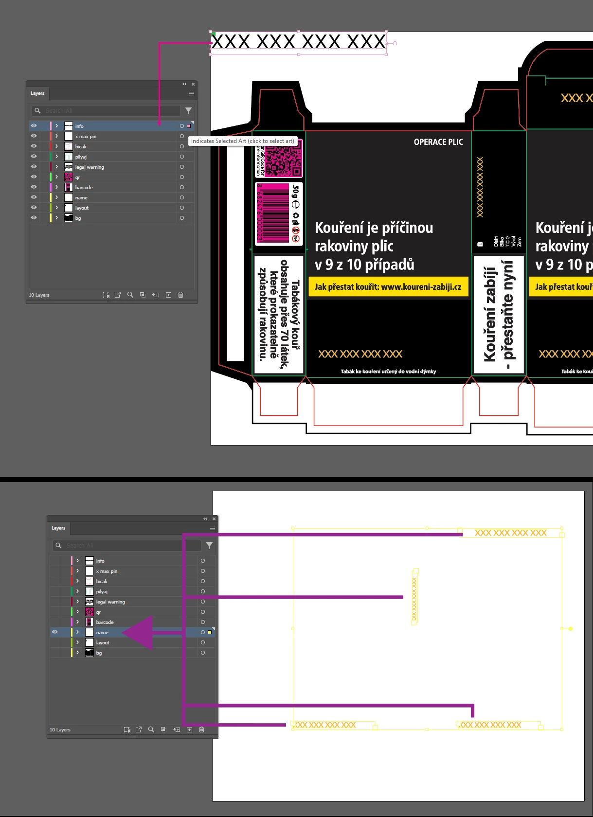

May 27, 2024 1:23 PM UTC
Hi @Zapt Works
Does the layer have a name? What is it?
Does the layer have the same name in all files?
Or to put it another way: can the layer always be uniquely identified in each file (eg by name or by position in layers hierarchy)? If not, then you would always have to "loop" through all the text fields in the file and check the content. I would like to avoid this.
Do you have a sample file for testing? (structured as described in your last topic)
Zapt Works
May 29, 2024 9:13 AM UTC
There are only XXX XXX XXX XXX text layers on two different layers. One is called "info", the other is called "name" as I show in the images.
