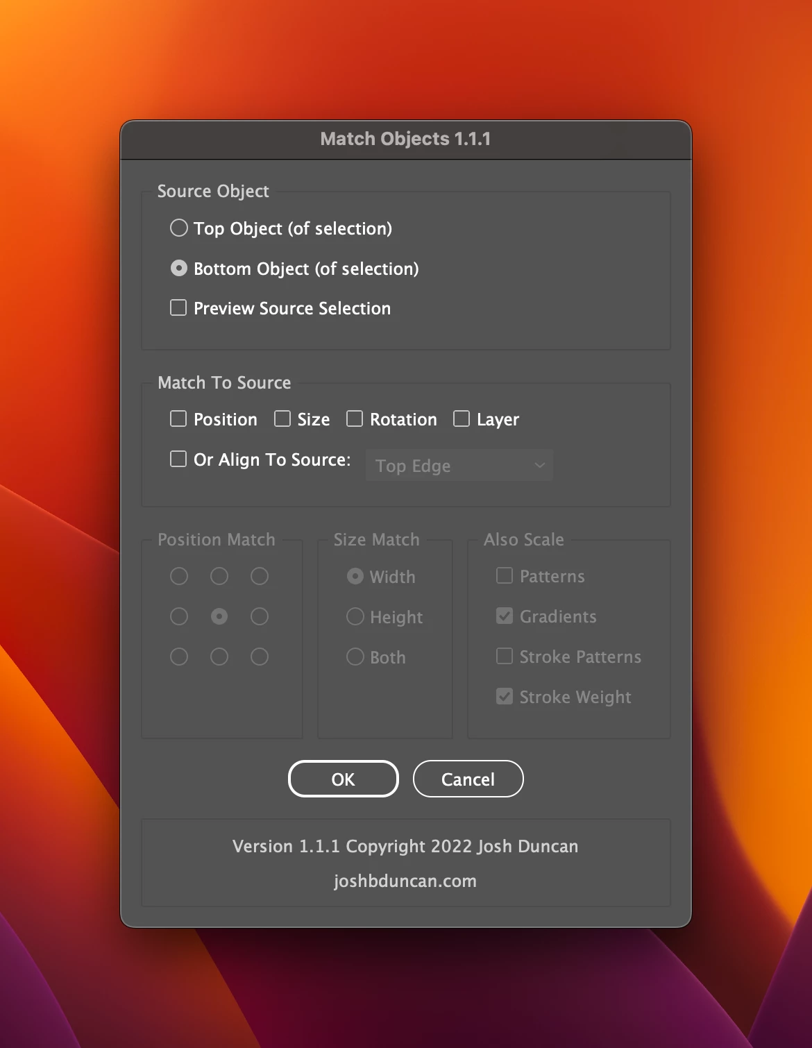

I'm wondering if anyone knows of a plug-in that allows me to replicate the X or Y dimension of an object with an already selected object?
For example... Object A is my desired height for Object B. Rather than copy & Pasteing the X dimensions, I would like to have Object B selected & automatically adjust after selecting Object A.
I ask this question as I have lots of different objects that need to be resized to already existing objects.
Correct answer jduncan
I've got a script called MatchObjects that does what you are describing (as I understand it). It does quite a few more things too, but it is pretty easy to use. Cheers!
Script Info: https://github.com/joshbduncan/illustrator-scripts#matchobjectsjsx
Script Download: https://github.com/joshbduncan/illustrator-scripts/blob/main/MatchObjects.jsx

Hey jduncan,
Incredible that you had just the thing! Using this now & it's great.
