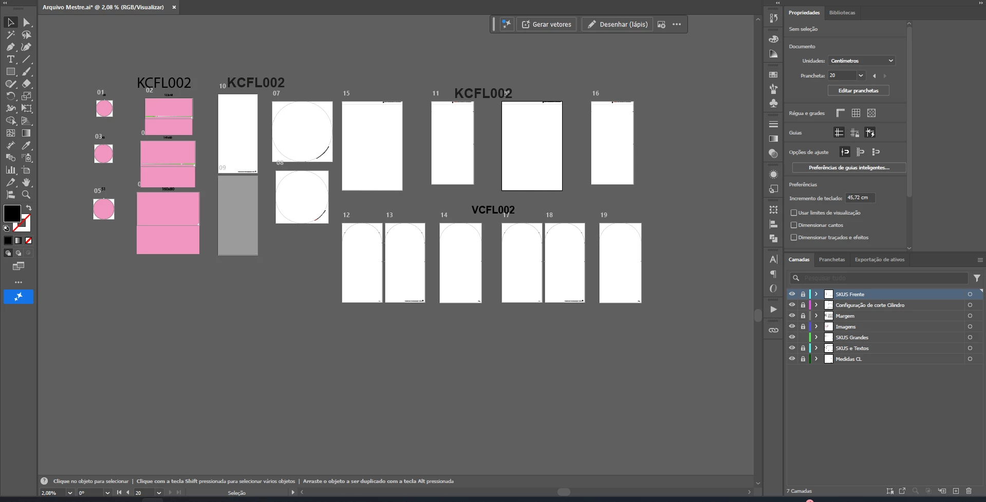

It’s a bit hard to see, but those large texts are my symbols. They are scattered across several locations on my artboards. I currently use white and pink images as placeholders, which I swap out using the Illustrator Links panel to keep things simple, as it automatically handles image proportions.
Here is how my artboards are mapped:
  • Cilinders: Artboards 1–6
  • Round Panel: Artboards 7–8
  • Smal Vertical Panel: Artboards 9–10
  • Vertical Panel: Artboards 11–15
  • Vertical Panel 2 (An variation, also used in VC): Artboards 16–20
These SKUs are temporary and determined by another team in my company. Currently, the process is manual: I fill in the symbols, export the artboards using a defined suffix/prefix, and then use a third-party tool to rename the files.
