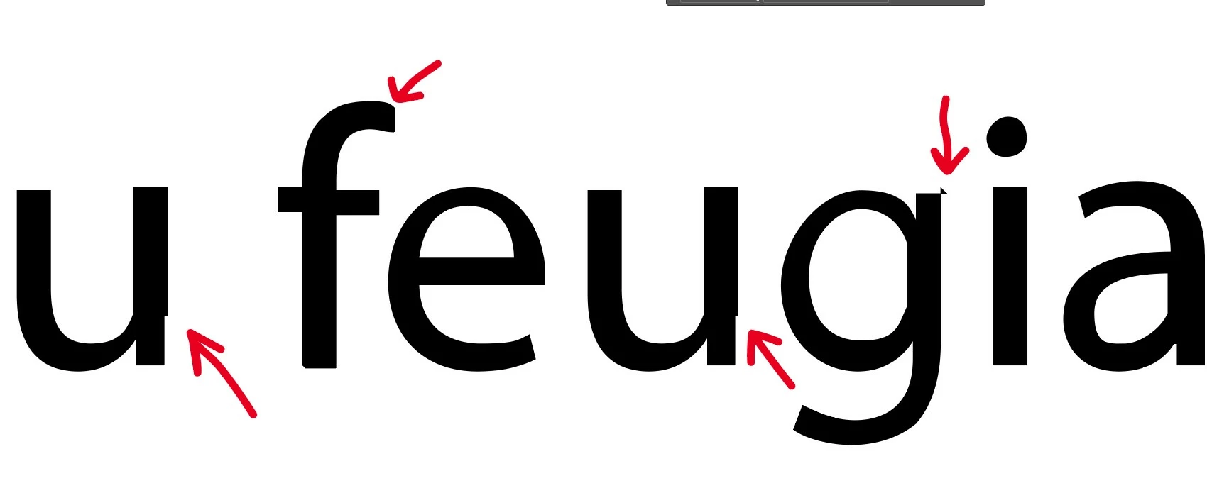

My Goal: I would like to convert my text to outline and save AI file as SVG. I am having a design printed on a T-Shirt and the printing company only accepts PNG, JPG, and SVG uploads.
Steps I Have Tried (Independently of one another):
  • Type > Create Outline > Save As SVG
  • Object > Expand > Fill+Object > Save As SVG
  • Export As > SVG [Font > SVG] (Also played around with the decimal settings)
  • Export As > SVG [Font > Convert to Outlines] (Also played around with the decimal settings)
Problem:
Closing out and opening back up the SVG files distorts the text and causes funky letters as seen in the attached image. I can replicate the problem with any font of any size. This has baffled me for the past 24 hours and I am convinced I am going about this the wrong way. Looking for a bit of wisdom and advice. Many thanks!

Monika Gause
Aug 13, 2024 10:24 PM UTC
When exporting, try and set a higher value in "Decimals" in the SVG options.
Aug 13, 2024 10:41 PM UTC
Thank you for the reply. While exporting, I tried decimal values of 1 through 10 with no luck. It seems to make the text more bold and squish together regardless of the decimal setting.
