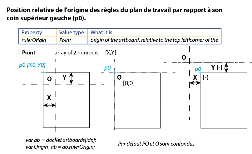

Pour l'origine des règles du plan de travail, c'est différent: (réponse de Lumenn )

Then as i've found here:
Change origin of artboard rulers
Rulers are per artboard, you have to set the origin for each arboard, for example:
app.activeDocument.artboards[0].rulerOrigin = [0,0];
Will set the ruler to top left corner of 1st - [0] - artboard in the document
