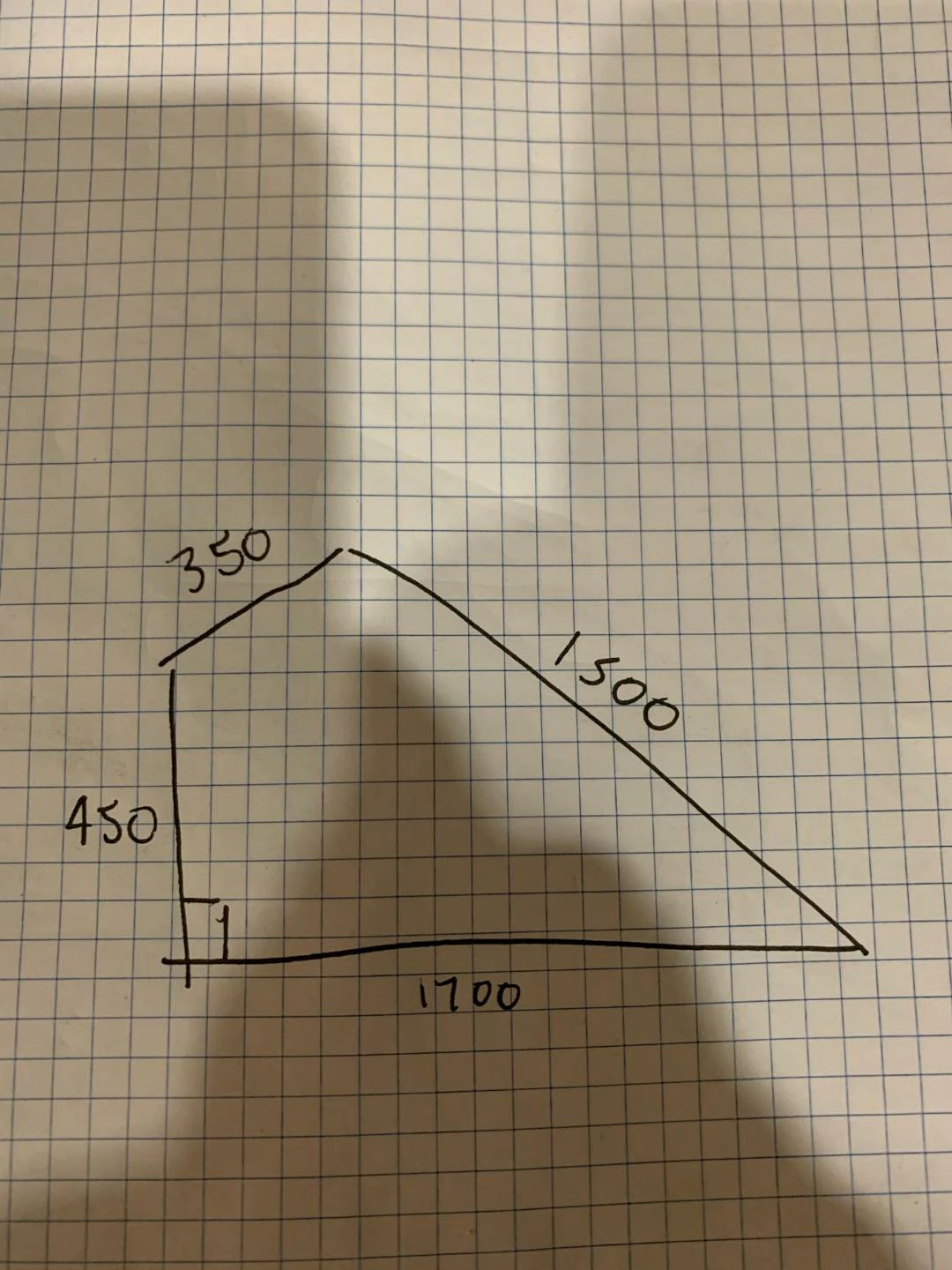

Please forgive me if this is really silly but I have been asked to resize a bespoke shape in Illustrator/check the dimensions. It's a closed path with 4 points. Is there a way I can custom edit the length from one point to another on each side of the shape to match the new dimensions? I tried direct selecting two points at a time but it didn't work, If how do I draw this shape in illustrator - 4 sides but all different length sizes. Thank you!

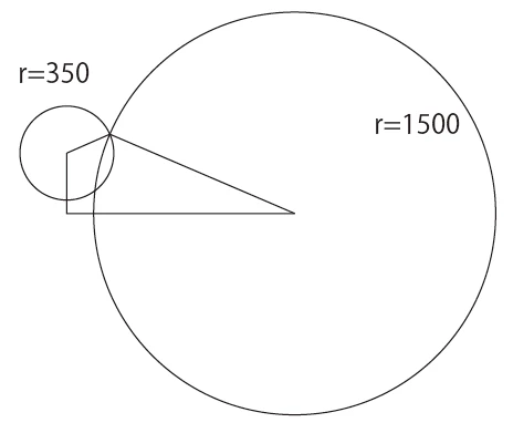

Thanks for your reply. Basically I need to draw this using the specified dimensions. How would you do it?
December 9, 2019
Hi
How do I draw a shape to be these exact dimensions? I will draw it at 10%. Thanks,

Hi!
Thanks for your reply. Maybe there's an easier way?
Basically what I'm trying to do is draw a shape in Illustrator, and the dimensions of each side have been supplied. Please see attached. How do I draw that to be those exact measurements (at 10%).
Thank you
December 8, 2019
Hi everyone.
I've been asked to draw this shape in Illustrator using the dimensions specified in the picture below (at 10%). What's the easiest way for me to do that? Thank you.
