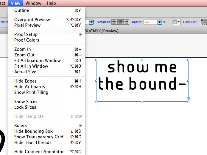

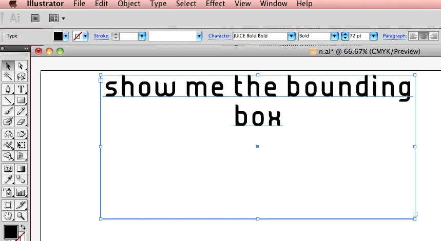

April 21, 2012
Sorry Steve,
Not sure what settings you have set in your illustrator prefs, but i'm rockin cs5.1 and for me showing the bounding box enables me to grab the corner handles of the text box with the selection tool (black arrow). and... this does NOT scale the type, it just opends the box up so you can see the rest of the words you are typing.
Here are some screens showing bounding box ON. and the 2nd showing the selection tool resizing the text box without scaling.
August 8, 2012
Yes, Bounding box ON, and then is possible to resize the text box with selection tool.
The text isn't scaled.
Thanks a lot
