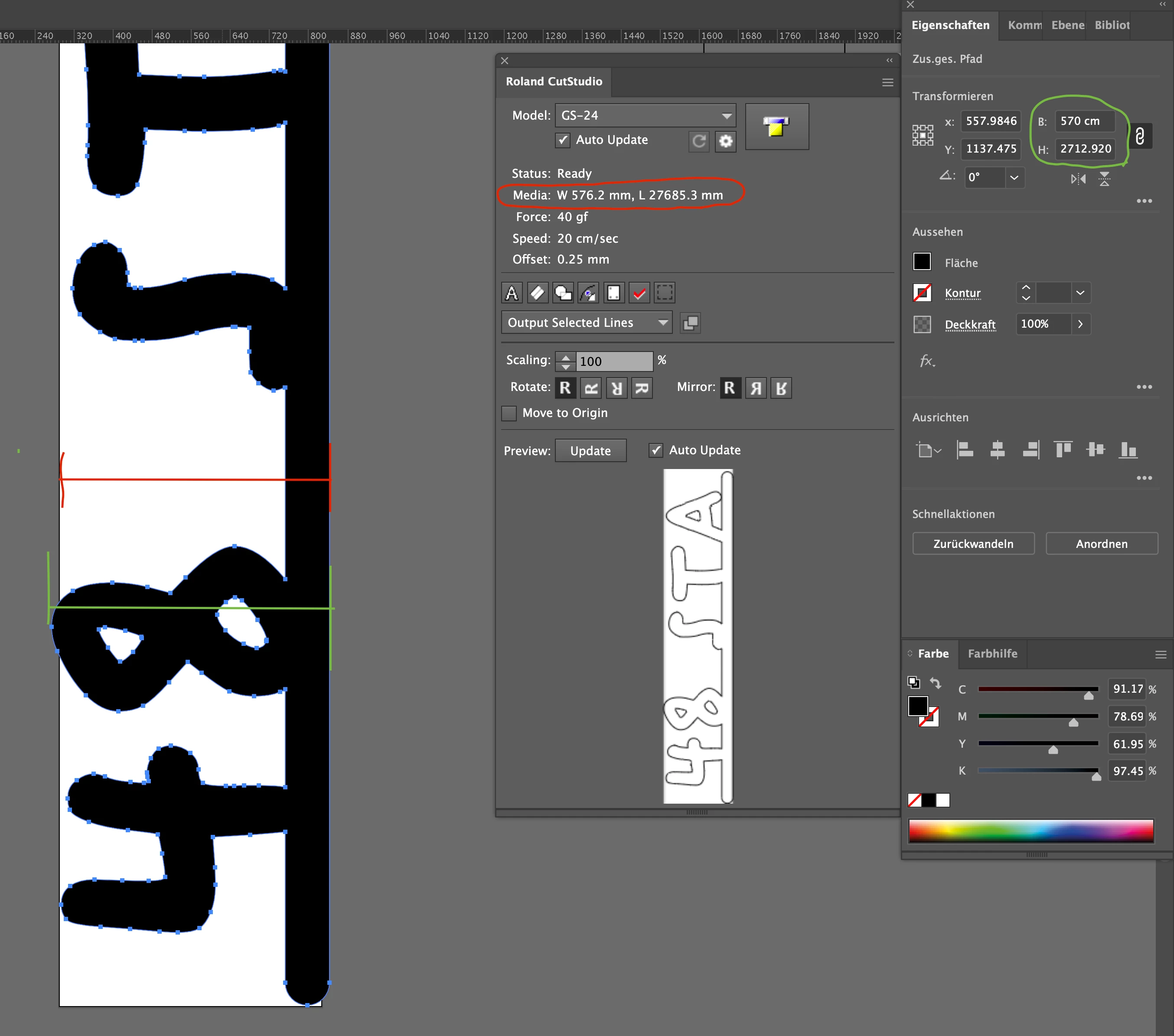

Roland Cutstudio Plug-In cm & mm did not correct. Where can I correct the steps?
  • February 1, 2022
  • 363 views
Hi..
I use the cutstudio plugin newest version.
In the Picture you can see is the problem from mm to cm.. 576.2 mm are not 576.2 cm!
Did anybody know how i can move the comma??
THX a lot for Help!!!

I suspect it is an issue with large size canvas documents (over 577 cm W/H).
Everything is scaled 10x in a large size document. Looks like the Roland plugin doesn't acknowledge that. Have you contacted Roland support to ask about this?
SPRÜHKRAFT
February 1, 2022
Ah, that sounds like a plausible explanation!
Many Thanks!!! No, unfortunately I don't have a connection to Roland... You?
