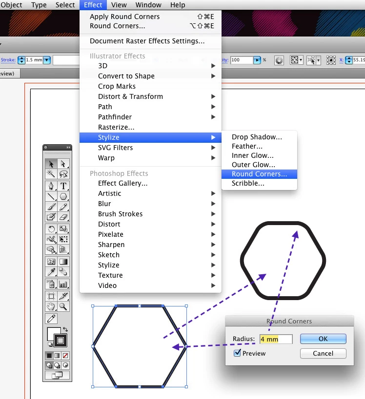

    TREX8905603
    April 19, 2016
    Hello trude0
    Have you tried this?.... example image below.
    I am using Illustrator CS5.1

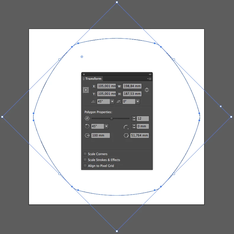

    Willi Adelberger
    April 19, 2016
    This would not make the 6 lines round, only the corner. Also the lines have to be round. This is easy with CC2015.
    With CS5 it is way more complicated than it is to be done in CC 2015.

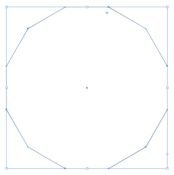

    Willi Adelberger
    April 18, 2016
    1. Create a 12 corner polygon
    2. Select every other corner with the direct selection tool and drag the widget of one corner for the small round a little bit to inside:
    3. Do the same with the other corner, drag the widget so far as you can inside
      4. Turn it to the position you want

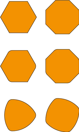

    Willi Adelberger
    April 18, 2016
    With this method you can also create similar rounded polygons:

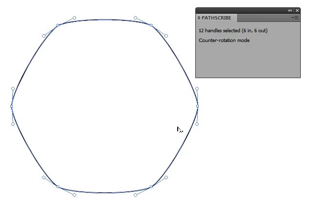

    JoeStudio
    February 26, 2013
    Vectorscribe/Pathscribe plugin can do this if you feel like paying for a very useful set of tools from Astute Graphics.
    http://www.astutegraphics.com/products/vectorscribe/movies.html#pathscribe

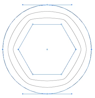

    Steve Fairbairn
    February 26, 2013
    Try doing it like this:
    Start off by drawing your hexagon and giving it a centre point (Attributes). Then draw a circle outside it from the same centre point.
    Direct select the side anchors only and make a blend between the two objects.
    Check how many steps you need, expand the blend and choose the rounded hexagon you like best.
    Mylenium
    February 26, 2013
    I always forget about the more creative uses of blends...
    Mylenium
    Mylenium
    February 26, 2013
    You would have to create it in 2 steps using 2 instances of Round Corners, possibly expanding the apperance and subdividing the path inbetween to reinstate some sharp corners the effect can operate on....
