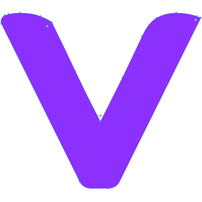

Rounded corners rectangle handle missing on certain anchor point
So I want to make the anchor on the top right rounded, just like I did on the top left. But for some reason there isn't a rounded corner handle available at this certain anchor. Al anchors in this object are joined though.
Why is this, and how can I solve it? Any ideas?

Hmh, I'm not sure if you perhaps shared a different file.
This is what I see when direct selecting the path.

I saw your wireframe (outline mode) showing the line, but on the color versions the furthest right 45 degree line on the "V" doesn't look like it's connected... it could just be a screen resolution anomaly of the posted screenshot, but if that isn't a closed path, you won't see the widget. The line in outline mode maybe a duplicate object below the purple one.

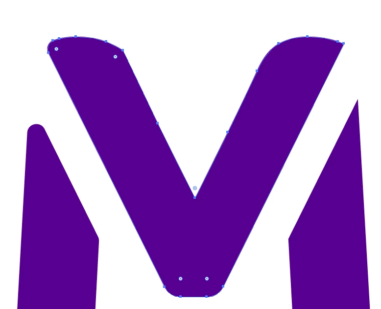

I can't see if your path is closed. Try the outline view.
Also: check if there are maybe duplicate anchor points on that corner.

Below are a few screenshots of the outline view, and zoomed in onto the top right corner.
The path is closed and it seems like there are no duplicate anchor points.

How did you test the duplicate anchor points? If you click on it one with the direct selection tool and move it, what happens?

I do see the handles to change the shape of it indeed. But unfortunately it won't let me add the rounded corner handle to it though. But maybe I have missed something in your description?
In my screenshot you can see the white dot within the top right corner is missing, while it is there in the top left corner.
