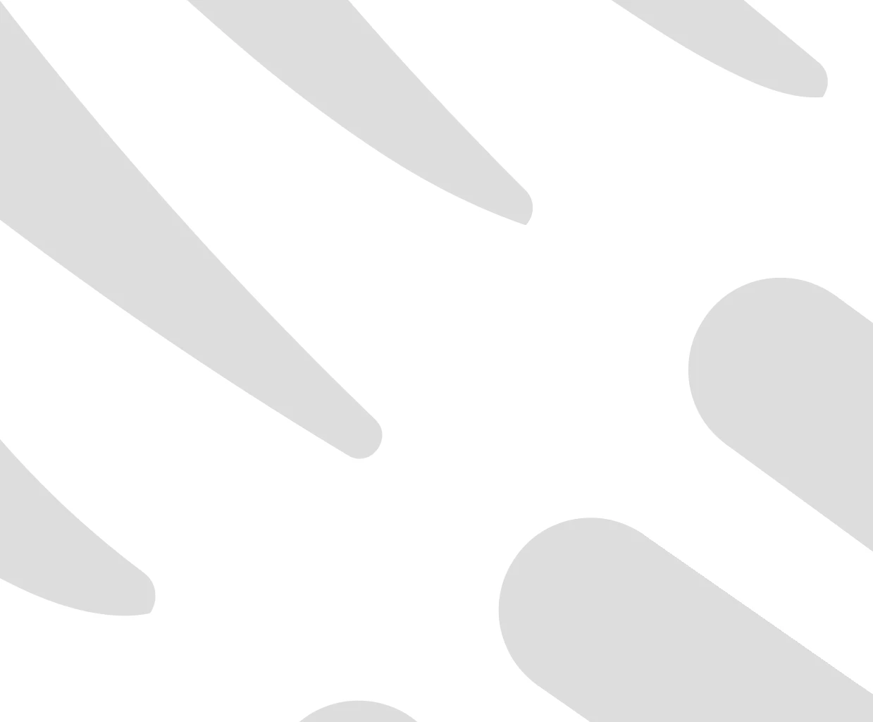

I am a design professional and illustrator who creates detailed line illustrations for a lot of my clients and packaging projects. I use the pen or pencil tool to create the line work, I often round me end and use the width tool to narrow my points. This creates an engraved/hatch look and style.
Well, I began noticing that new and old files are no longer holding the rounded width value that they used to. Meaning, when I create a new illustration and specify the line wifth I want and round the edge, Illustrator seems to glitch and just say "nope" and gives my entire line a very pointy appearence.
What's more is older files that used to have the corect line width with a rounded end now load as a sharp unppealing line.
If you are having a hard time visualzing what I mean here is a preview:
This is what my lines usually look like when they terminate (these have not been refined but you get the idea):
This is what happens now. I cannot figure out why this happens or when becuase not all lines are affected:
You can see that the lines on the right are odd and mishappen. Illustrator did this whout any input from me and it also not affects my old work. I open up old files that have 40+ hours of intrquet line work to now see some lines looking aweful! Really sad and rustrated about this. Any input woud be very helpful.

Thanks Anshul. GPU to CPU and vice versa produces no results.
I will mention that I did notice this happening after an update. There was a line in the sand but I do not remember the update that did it.
Here is the AI file where I isolated two strokes edited with the width tool that have been affected. If the circled areas are normal and rounded then te issue is only on my end. What you should see is the line terminates very oddly, it\'s not rounded, it's not pointy. It's just mutated.
The point values vary since it tappers.
Thank you
Tinman1028
February 20, 2023
I'm working on more illustrations today and here are more examples. I am making one line at around 1pt. Then using the width tool to organically taper it. The result is exactly how it shows live as I adjust it (it gets smnaller and maintains rounded point). Then I make another line, same process but once I let go of the width tool adjustment the line morphs to this odd looking point. Same with the next line, then another line is fine, then another line morhs. It just seems like a bug...

See below, this is a good example. See how the selected line now ends in a half rounded point? When I saved this on Friday this line was jus tlike the others around it?! It's possessed.
Here is also some elemetns from the file. I circled 2 elements that are rendering odd on my end. If they are normal on your end then it's something with my software or settings.
