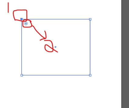

1 - Use the direct select (Hollow arrow) tool to make the point you want to edit solid, leaving others hollow.
2-  Drag the circle to round just that point

Use the direct selection tool and drag a rectangle around those two corners. Then there should be a fat circle with a point inside it in each corner - the "widget". Then drag one of them. The other should follow.
If the widget is not there: try View > Show corner widget. Also: zoom in.

That did it! Clicking on the rectangle wasn't working, but drawing a little rectangle around just the top two corners did. Thank you!
