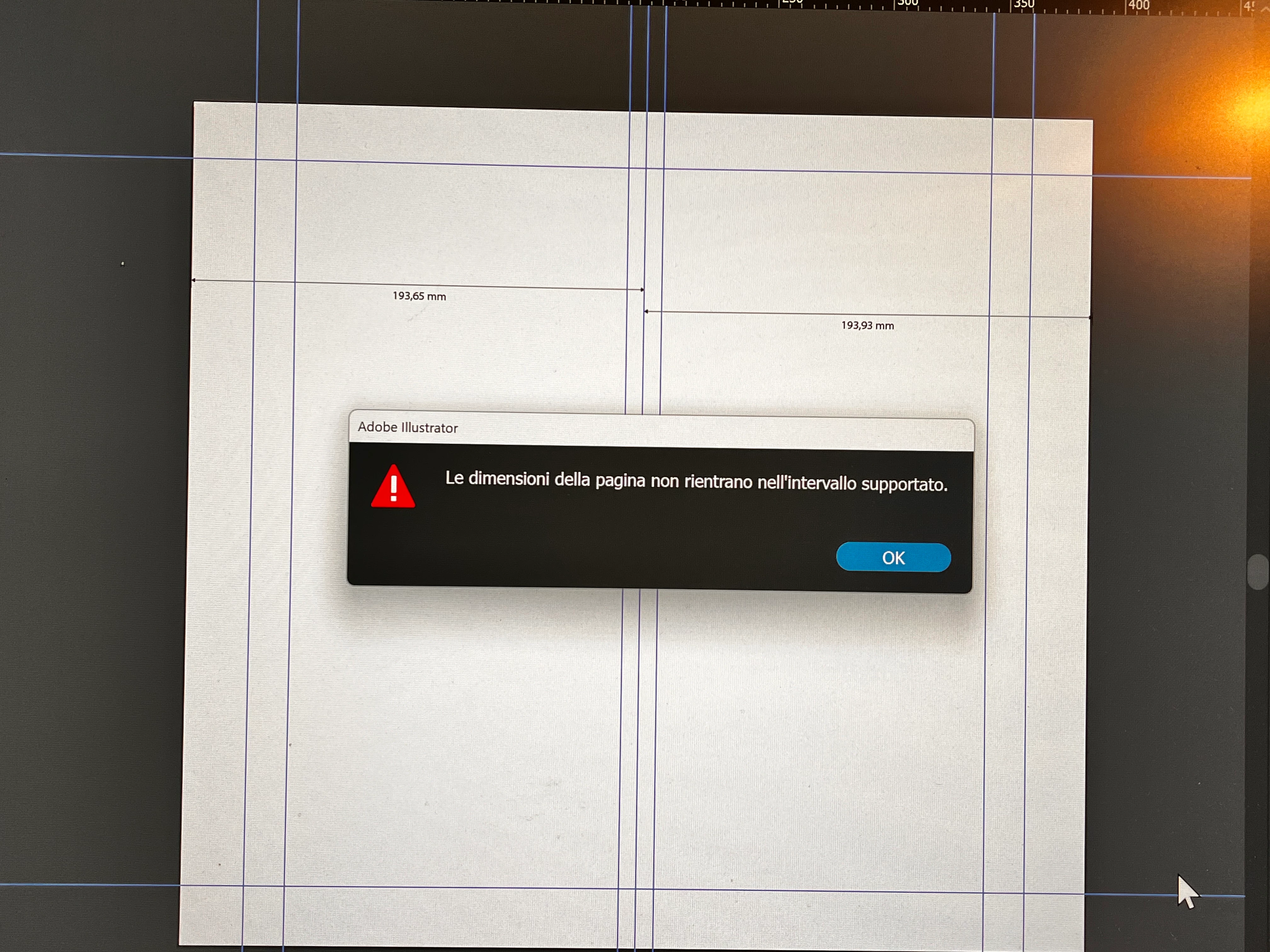

Good evening. Without having changed anything, when I wanted to save a document in PDF, this note appeared: "The page size is outside the supported range" - But my document is a normal format of 300x400 mm... How is it possible that I am prevented from saving it???

And you are sure about the correct unit?

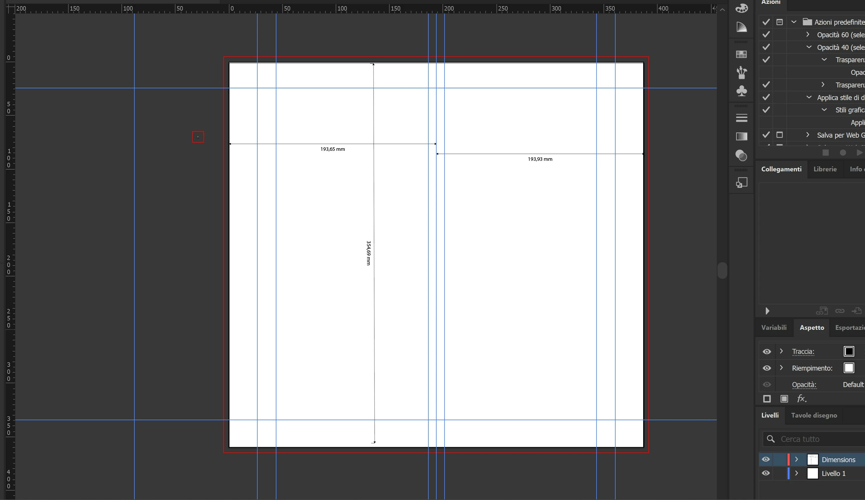

Can you show the artboard options?
La colpa era di quel riquadro piccolo a destra del documento > ◙ che non essendo compreso nell'area del documento mi impediva il salvataggio. Ci sono arrivato da solo. Vi ringrazio comunque per la collaborazione.

Can you post screenshots that show your document setup and also how the artboards are set up?
