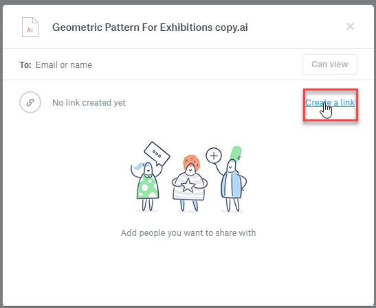

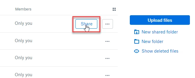

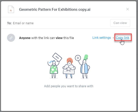

    I'm not having any luck viewing that Dropbox link... I'm getting a message saying I probably shouldn't be here.
    Could you kindly check the link is public and shared again and then try re-posting?
    I'm sure you know how to use Dropbox but just in case anything went awry...
