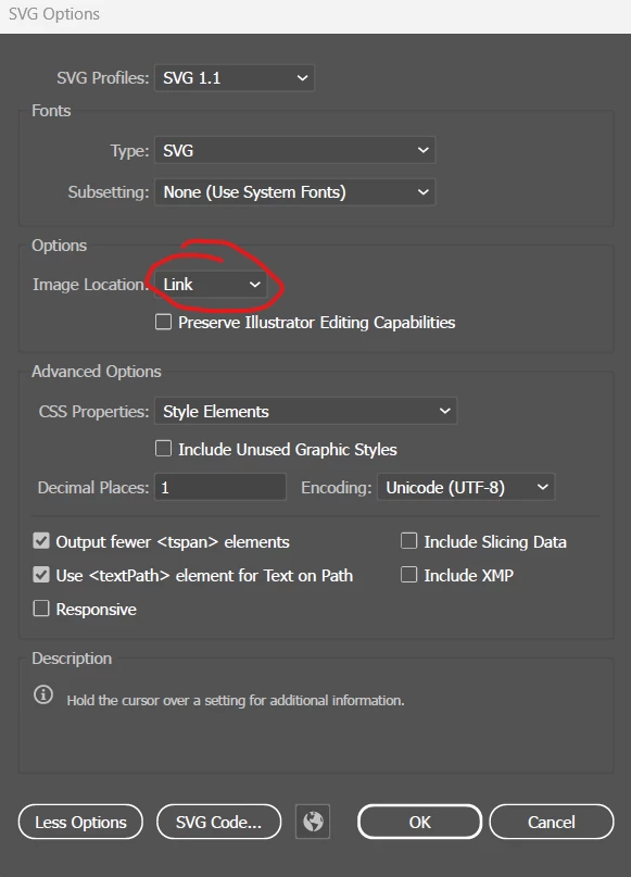

Doug A Roberts
Oct 10, 2024 1:43 PM UTC
Use the image location option to set images to link when saving:
