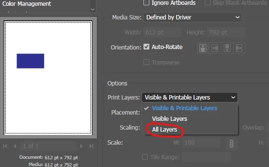

    I also am seeing both screenshots looking the same in colors.
    What I know is that this setting here says print, but more properly should say PDF & Print. So change to all layers and then save a pdf. Also check your layers if the visibility eyeball is on for all of them you want on the PDF.

    Hi Mike... Thanks for replying! Unfortunately, I'm not seeing this box the same as you. I'm on an iMac (not sure if you are). I clicked on PRINT and then Color Management. I get a different looking window. See attached.
