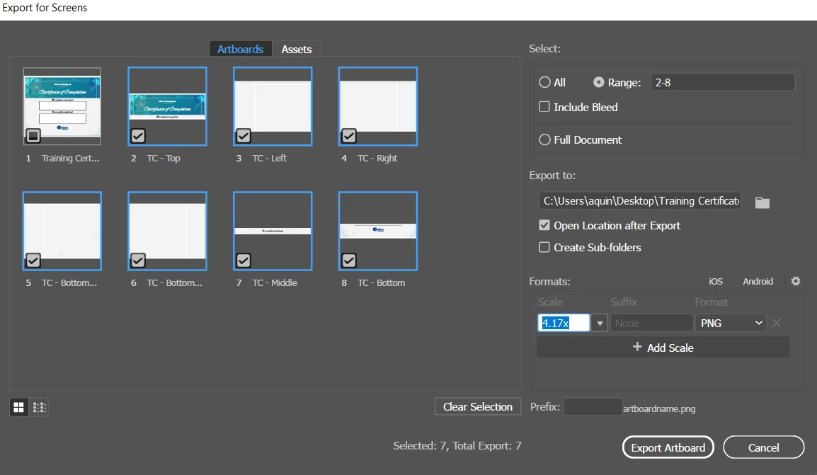

JETaalmage great background. But here is the answer user jddigidesigns​ was probably looking for.
File >  Export > Export for screens > Formats (right section),
in the Scale box type 4.17. It will multiply the default export from 72 ppi, to 300 ppi.  (FYI: I clear out the Suffix)
