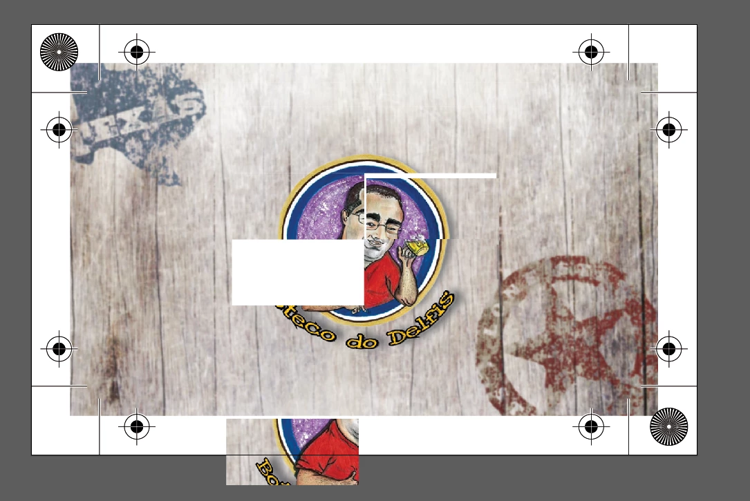

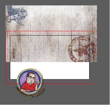

So I have this problem that it appears when I save to PDF/X-1a.
The PDF file merge all the layers and cut the art in some pieces.
(I noticed that the problem only occurs with projects that contains "jpeg's" or "png" on it)

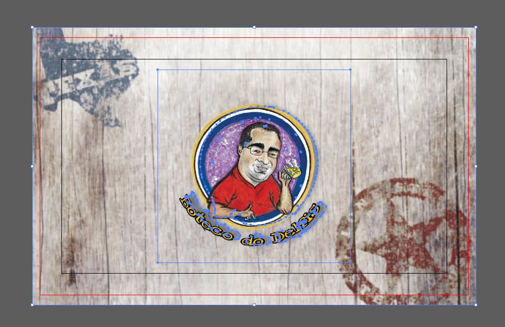

I was creating a business card for my friend, and he asked me to use a specific background.
You can see that at this point, nothing wrong happens (it's a simple project with two layers)
But when I saved in PDF/X-1a (so I could print), I noticed that the file had something wrong.
So I opened the PDF in the Illustrator, and the layers were merged and cutted in random pieces
In this case, I only used bitmap, but there was one time that I used bitmap and vector, and the same error occurred.

I noticed that with the X-4 everything was the way it's supposed to be, but unfortunately, here in Brazil, all the print companies only uses PDF/X-1.
The only solution that i've found, was to rasterize the transparent layer with the background, and don't do anything to texts.
(but if it still happens, just rasterize everything)
