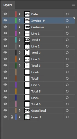

July 6, 2020
Thank You for that. I didn't expand the layers and it's actually the sub layer information i need. Very sorry i didn't mention that before. I hope it doesn't make it harder.
femkeblanco
July 6, 2020
Going by your photo, you want to target the first sublayer in the second and third layers. So try this:  (again fill in "..." in your path)
var sublayer1 = app.activeDocument.layers[1].layers[0];
var sublayer2 = app.activeDocument.layers[2].layers[0];
var address = "‪/C/Users/.../Desktop/" + sublayer1.name + "_" + sublayer2.name;
var file1 = new File(address);
var PDF = new PDFSaveOptions;
app.activeDocument.saveAs(file1, PDF);
pixxxelschubser
July 6, 2020
For clarification, please show us a screenshot of the Layers panel with the layer names. Or upload a sample file (without confidential data) to a host of your choice (e.g. Dropbox ...) and link to here.
July 6, 2020
I attached a photo of the layers
