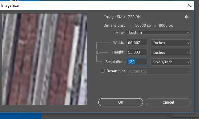

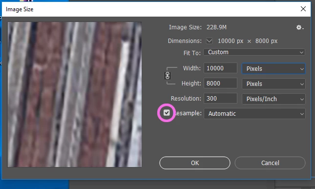

maxwithdax
October 2, 2018
Chris,
Think of it this way...
DPI is the clarity at a specific size. The size is directly proportional to the resolution. The larger the size, the lower the resolution.
So it is best to start with this question. What is the largest size I want to offer this printed at?
If my file is 8000 x 10000 then I know a few things.
1. At 300dpi this image will produce a 33.333 x 26.667 inch image
2. At 220dpi this image will produce a 45.45 x 36.364 inch image
3. At 150dpi this image will produce a 66.667 x 53.333 inch image.
The file is the same. The resolution is baked in unless you resample it. It is just a matter of how clear of an image you want based on what size you are printing.
So to directly answer your question.
You design your file with the print size in mind at 300dpi and the resolution will be what it is. In your case, 33.33 x 26.67
You can play with what size something will be by going to Image > Image Size and unchecking the resample box and then adjusting the resolution. You will see the units change to inches and tell you what size it will print at the given resolution. Or, with resample unchecked you can play with your file dimensions (inches) and see what resolution you will print at without resampling.
Hope that helped
- Dax
Silly-V
October 2, 2018
Keep in mind that Image Size is a Photoshop feature.
maxwithdax
October 2, 2018
Thanks Silly-V.
He started by saying that his art is 8000px x 10000px which is a raster measurement.
My question - Is it better to save at a high resolution with lower dpi (150) or lower the image size and save at higher dpi (300)?
Of course vector art is infinitely scaleable and resolution is inconsequential. And of course a pdf would be the best option to retain scaleability. But it sounded like he was taking something vector and outputting it to raster. So I just went with his initial workflow.
Hope I explained that the right way.
I agree with Jacob Bugge as far as PDF being the best output if you are trying to keep things vector.
-Dax
