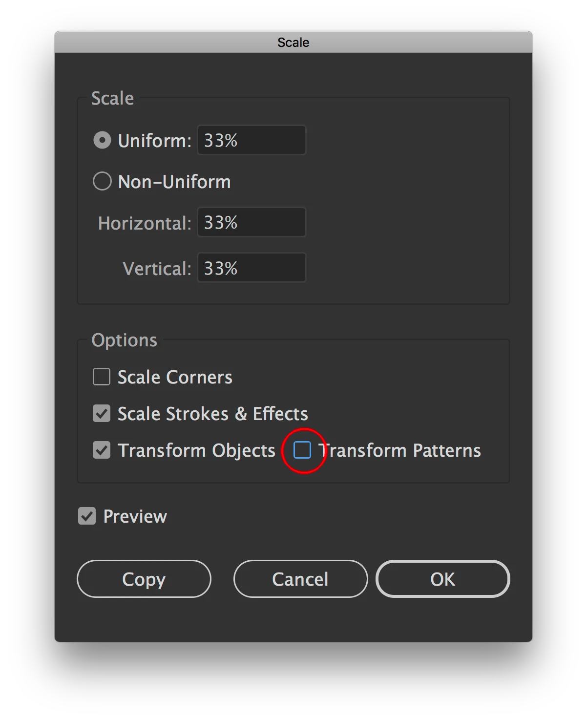

    Is easier to create  rectangle the size you need, and pull the gradient annotator handles afterwardss.
    If you need to resize the rectangle and not the gradient contents, would make a copy on top and use as a mask.
    If it was a pattern, you could uncheck pattern, but that does not exist for gradients.
