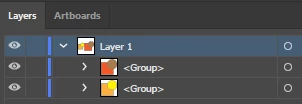

A way to do this is to make sure your item is in a group, then use the .resize() function to scale it.
In my example, you can see I've grouped some shapes and I'm using the resize() command to increase the size of one of them 150%;
This is a great learning example, btw - just to scale something is a very basic thing you can do to learn a lot of code principles.
