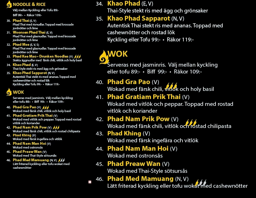

I have a text box grouped with a shape. If I scale them while holding SHIFT, the text and the shape enlarge, but the shape doesn't maintain its relative position to the text.
How can I scale text with shapes without converting the text to outlines?

BilderbergCEO
December 14, 2018
Thanks for the quick reply:)
Here's a screenshot. Notice how the shape near WOK and the chilis change position.
Monika Gause
December 14, 2018
And the text is an area text?
What you're doing there will work a lot easier in InDesign.
BilderbergCEO
December 14, 2018
It's regular text made with the Type tool.
Yeah, I thought about doing it in InDesign, but I'm passed the point of no return now .
Sjaani
December 14, 2018
It should be working, having the objects grouped should be enough to have them maintain their relative position to each other. Holding Shift just scales them proportionally.
I agree with Monika, a before and after screenshot may help to work out why it hasn't worked as expected.
Monika Gause
December 14, 2018
Please post screenshots
