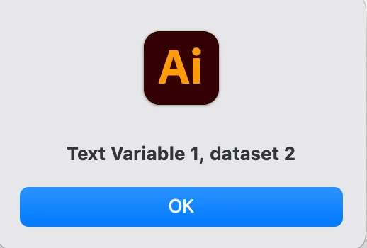

here you go, I added setting a dataset to my previous script
// cycle through DataSet variables
// https://community.adobe.com/t5/illustrator-discussions/script-access-to-variables-and-datasets/m-p/14971636#M426387
var idoc = app.activeDocument;
var vars = idoc.variables;
for (a=0; a<idoc.dataSets.length; a++) {
    idoc.activeDataSet = idoc.dataSets[a];
    for (j=0; j<vars.length; j++) {
        //$.writeln(vars[j].name + ' : ' + vars[j].pageItems[0].contents);
        alert(vars[j].name + ' : ' + vars[j].pageItems[0].contents);

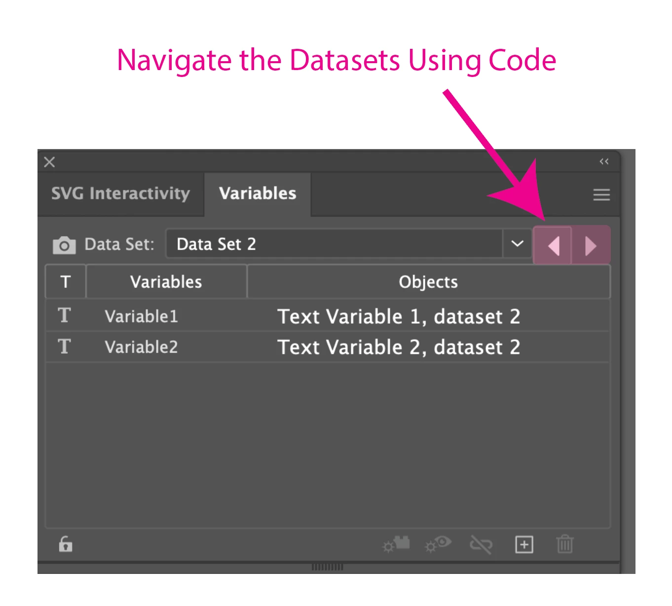

I am looking for a way to script the navigation of the datasets so I can use the information stored in different records ...  for Variable1 access the data from both Dataset1 and Dataset2.

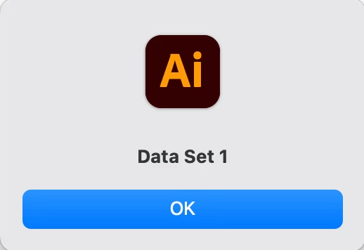

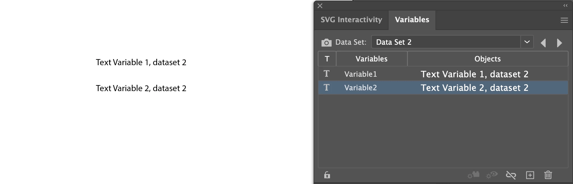

I was able to access the following::
// Data Set 1
app.activeDocument.dataSets[0].name;
// Variable1 of Data Set 2 because it is active
app.activeDocument.variables[0].pageItems[0].contents;
So the real question is how do I iterate thru the datasets so I can return the contents of any given variale from any given record.? Changing the dataset index dataSets[0] to dataSets[1]  did not change the pageItems focus.
