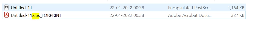

Surya24Author
January 21, 2022
Thank you so much for your response, but i am getting the extra word like ".eps" in saved file name. Refer the below screenshot.
Charu Rajput
Charu RajputCommunity ExpertCorrect answer
January 21, 2022
It may be because, pdf is created from the eps document(this is active now) and eps document name is Untitled-11.eps and app.actievDocument.name return name with extension. So extract name first as
var _name = app.activeDocument.name.replace('.ai');
and use _name where you have used app.activeDocument.name while saving in eps or pdf format.
