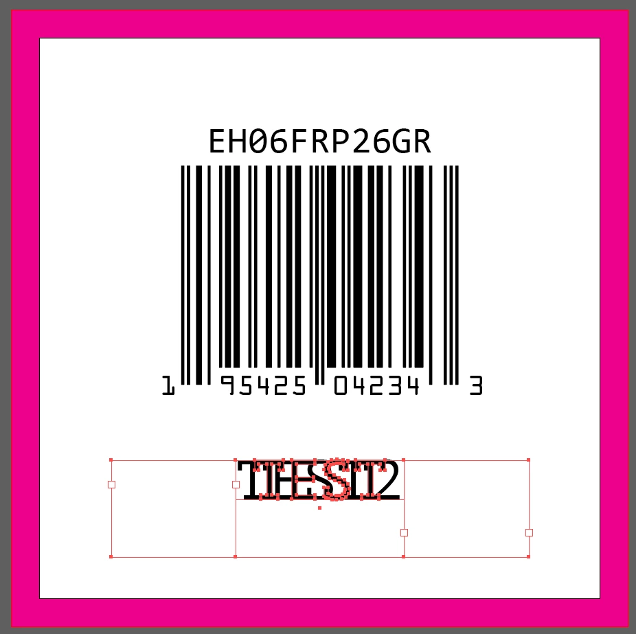

3. How do I get the outlineText to grab all text frames? For some reason it's only outlining the first layer.
That's not what I get from calling outlineText().  It outlines all textFrames on all layers.

The outlineText is still only running on my first layer though. Here's how my test file is setup: It's a barcode sticker, so I have 3 layers, _Artwork, which gets ignored in the static array, then 2 barcode layers with an EPS and UPC sku text. Those layers have the SKU as they're title. When I run the script, it's only outlining sku 1. I really want it to embed the EPS, then outline all text. Do you have any ideas on how I can change the script to manage that?

quote
The outlineText is still only running on my first layer though. ... I really want it to embed the EPS, then outline all text. Do you have any ideas on how I can change the script to manage that?
The problem may be the layers being made visible, invisible, visible, invisible, et cetera, the logic of which is not so easy to follow.  Some layers being invisible can cause unexpected behavior.  Try deleting or commenting out this (lines 29-31 or thereabouts)
for (i=0; i<variablelayers.length; i++) {
    variablelayers[i].visible = false;
Is making the layers invisible necessary?  If so, can it be done after outlining the text?
