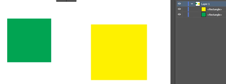

Here we shall start with one green and one yellow square which have different sizes:
Let's try to align the yellow one to the green one.
First concept is that in an Illustrator document, the art objects are inside array-like collections and those are directly tied to their stacking order. If we wanted to grab a hold of the green one, it would be the 2nd item in this collection of Document.pathItems at index 1 because in javascript all counting is started at index 0. The yellow item would be in index 0 therefore.

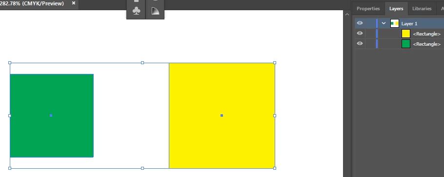

	yellowSquare.top = greenSquare.top;
test();
And now the result shows that after making the yellow square's .top property equal to the green square's .top property, they are aligned to the top of the green square!

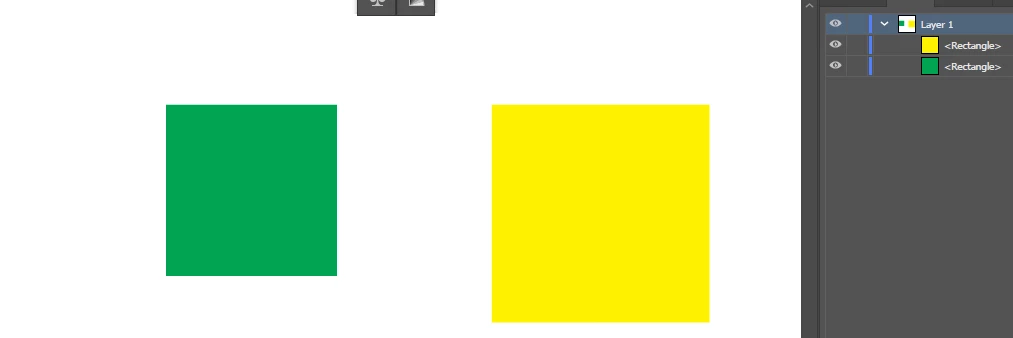

	var heightDiff = yellowSquare.height - greenSquare.height;
	greenSquare.top = yellowSquare.top + (heightDiff / 2);
test();
First, I get the difference in height between the yellow and green square because they are of different height sizes. When this difference is divided by two, theoretically we should be able to add this number to the .top of the green square to get it vertically aligned to the middle of the yellow one. However, the result I get is not as expected:
This was done because 1) I needed to refresh my own memory obviously, it wasn't on purpose 🙂 and 2) to also show you an Illustrator elimentary 'gotcha' when it comes to the coordinate system: it's actually reversed vertically. So unlike in its own UI or in web design or anywhere else, in Illustrator scripting the Y values have to be subtracted from instead of added-to in order to move something downward and the reverse for moving something upward.

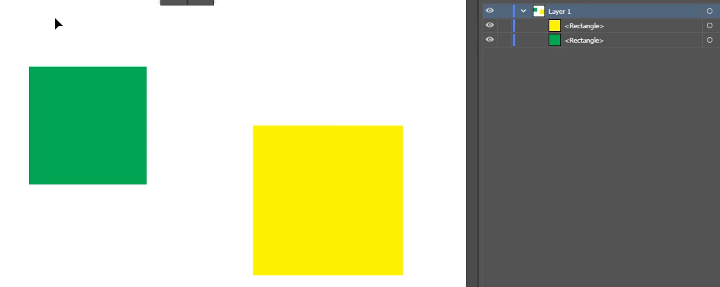

	greenSquare.top = yellowSquare.top - (heightDiff / 2);
test();
And now we can see the green square is perfectly vertically aligned to the middle of the yellow square.
The difference being, I changed the operative line greenSquare.top = yellowSquare.top + (heightDiff / 2); to use the minus instead of plus so it looks like this: greenSquare.top = yellowSquare.top - (heightDiff / 2);.
