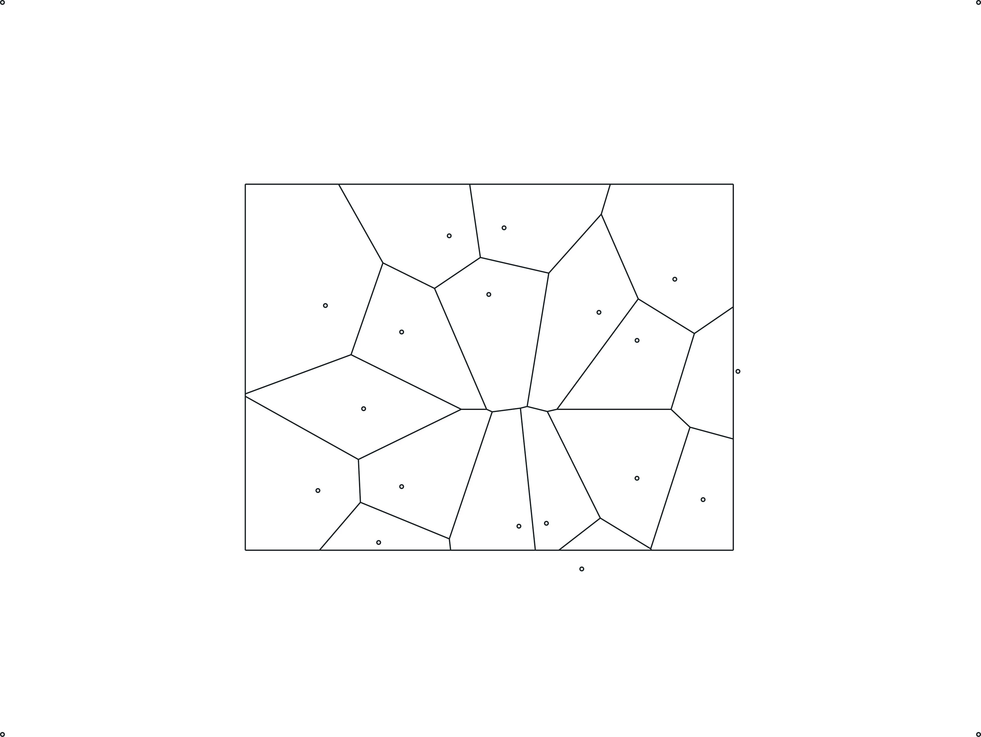

Wonder if anyone has the time to take a look at this? I'm not sure if links are allowed here, but if you google "github illustrator veronoi", one of the scripts:  voronoi_from_selection.jsx
is giving me puzzling results. If I make a simple shape and select all, and run the script. I get veronoi cells as the output, but within each cell is a circle. Wonder if you could reproduce this and perhaps figure out why. This makes what I'm trying to achieve such a headache as to eliminate all these little circles on a complex image would take ages..
Thank you. Here's an example:

Yes I never thought to search google images for an example. I feel silly now! Maybe I could modify the code such that the circles are not drawn. If I use a simple object I can watch the process and the lines are drawn first with the circles added at the end. Programming is not my best skill, but maybe I can "rem" a line at a time until it stops doing that . Ton that would be my next option..thanks.

Here is an explanation I found...
a Voronoi diagram is a partition of a plane into regions close to each of a given set of objects. In the simplest case, these objects are just finitely many points in the plane. For each seed there is a corresponding region consisting of all points of the plane closer to that seed than to any other.
It seems that is how the script was built.
