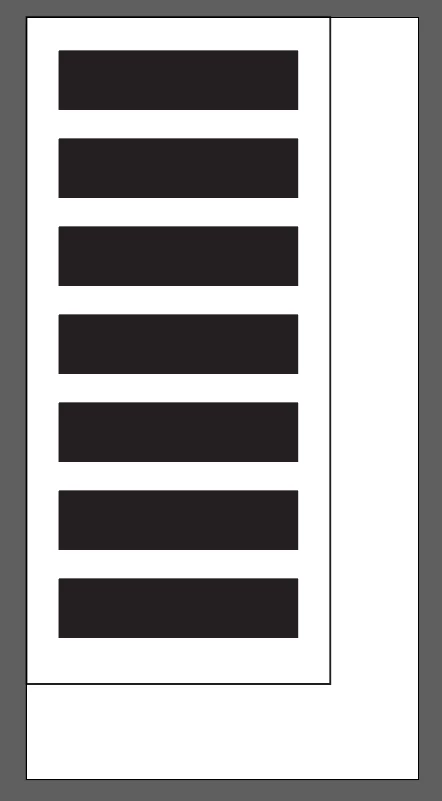

Can I rotate the content of an artboard with  180 degrees with a script?and optional : to save in ai format but for an older version than  CS6
I know it's possible with an action, but it's about several files with different formats..

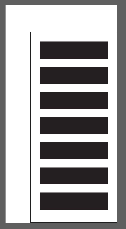

the rotation  must be as in the picture I attached above..as if you were rotating the artboard and content
Thank you
