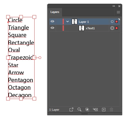

Hi!
I have a textbox , xText1, containing words
Circle
Triangle
Square
Rectangle
Oval
Trapezoid
Star
Arrow
Pentagon
Octagon
Decagon
 I want to loop and create seperate text boxes containing each word, having the corresponding word name
Any ideas?
Correct answer femkeblanco
To convert the contents of the textFrame into an array, split by the carriage return (\r).  You can then loop through the array:
// select textFrame
var text1 = app.selection[0].contents;
var text2 = text1.split("\r");
for (var i = 0; i < text2.length; i++) {
    alert(text2[i]);

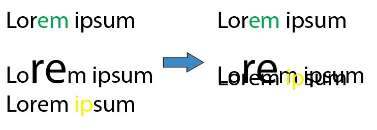

 Check out these great results! The text can be totally arbitrary.
CarlosCanto
February 12, 2022
Hi Vasily, thanks for sharing!
I get this

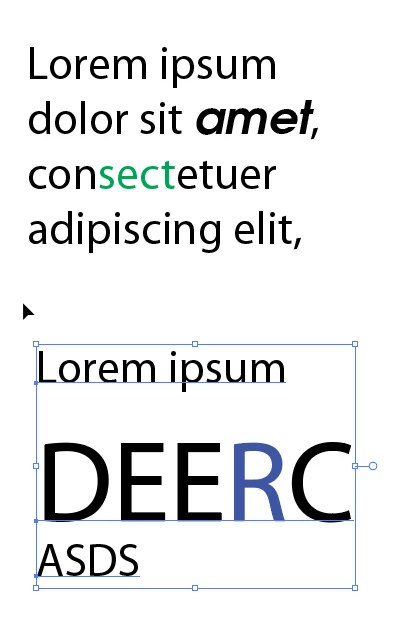

Silly-V
February 13, 2022
Hmm, maybe something is going on which may throw a wrench into the whole thing.
Do your texts look somewhat like this?
femkeblanco
February 12, 2022
I started writing a script, then I remembered that John Wundes had already written one.
https://github.com/johnwun/js4ai/blob/master/divideTextFrame.js
(I presume that you mean separate textFrames, not separate layers, since your image doesn't show separate layers.)
siomospAuthor
February 12, 2022
I know this script , i was hoping for simpler , without getting text position , justification
Just the loop for getting the array
Anyway, I will try to adpat it
Thank you @femkeblanco
