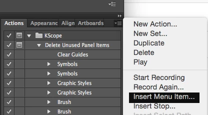

    I do that with an action, but that works since I save to my desktop, and uses my last used pdf settings. I add a stop, because illustrator crashes when action have steps the perform very quickly next to each other. If you record the action and choose the folder your file resides in, un fortunately any future running of that action will save to that same folder and not next to you .ai file.

    Actions in Illustraror have sadly never been updated and are very limited.

    Actions do record most menu commands, there is even a way to add stubborn ones to record if needed.
    Not sure what exact steps you took to try an make an action, but you should be able to record all the steps I have shown. You can then insert a stop as I did using the fly-out  menu in action panel.
    Did you make a new action or miss that and the steps got added to an existing selected action.
