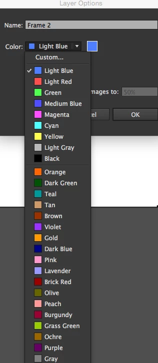

I was wondering if anyone knows of a script that would allow me to change selected layers (either single or mulitple selection) to "Light Blue" or any colors within the drop down selection? (see attached screenshot)
I've found the following but it changes all the layers and it's RGB color.

as far as i can tell this is only possible with some other changes.. Since 'selected' isn't a property of 'layers' then javascript can't determine whether you see a layer as highlighted in your layers panel.
you could do this one of 2 ways. Depending on how many layers you want to change the color of, you can either make those visible or hidden (for example, if you want to change 80% of the layers to a specific color, hide the other 20%). then just add an if clause inside the for loop.
