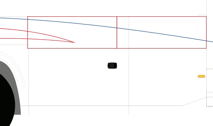

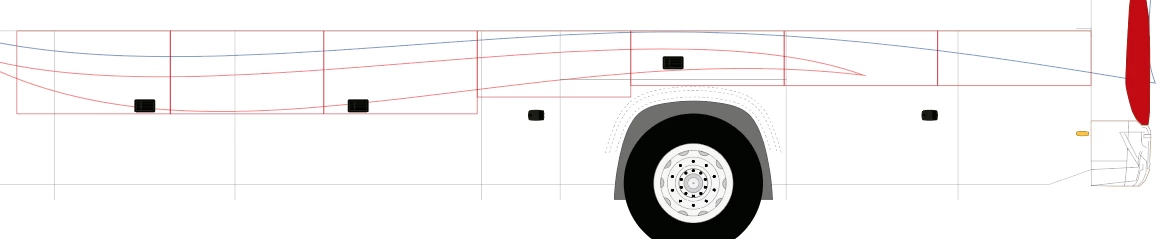

So that's what I'm trying to do: I work in a company that does a bus, and for that, whenever we're going to paint it, it's necessary to create "paint masks", which would basically be "ways" to make it possible paint the drawing correctly.
Each paint mascara is made in one frame, and all lines within that frame need to be trimmed.
Currently this is done manually (cutting line by frame line).
In the image, it shows the drawing (lines) and the frame.
What I would like to do is: Create the frames throughout the car's extension and later run the script that would automatically cut those lines (if possible).

This looks great, unfortunately I'm so busy at this week that I won't be able to really do much about it, but I believe one of our residents of this forum could craft just the right workflow for you.
At the outset, I think my first step would be to ensure the lines are duplicated as many times are there are boxes, and each gets stacked and grouped in such a way that a Divide operation could create close to the result you want.
